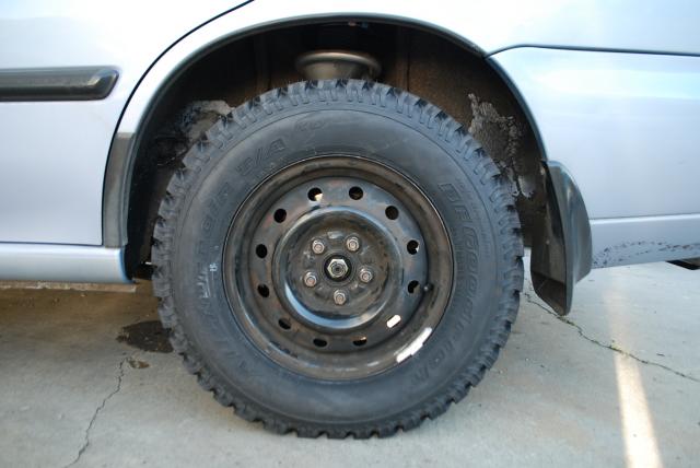

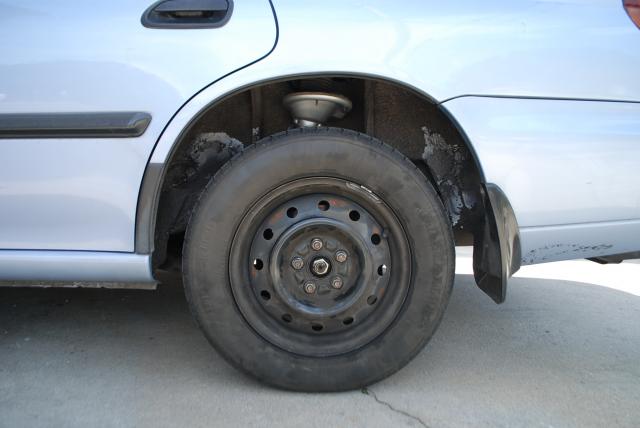

venicebean Posted March 8, 2011 Author Share Posted March 8, 2011 got the rears done: Link to comment Share on other sites More sharing options...

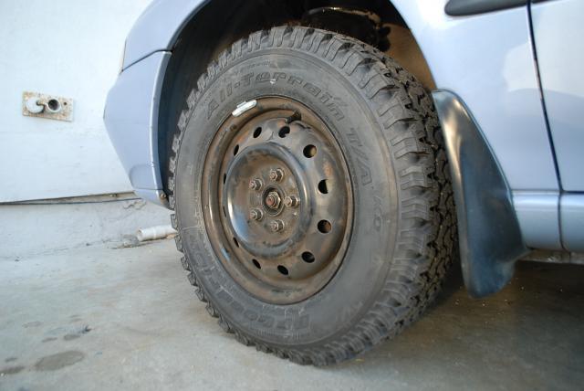

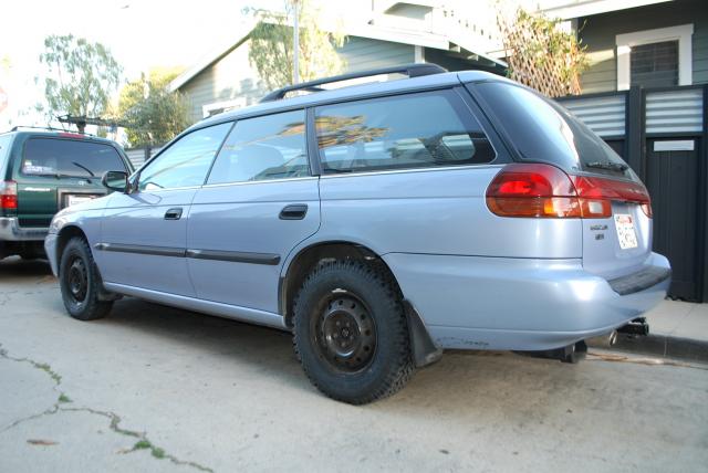

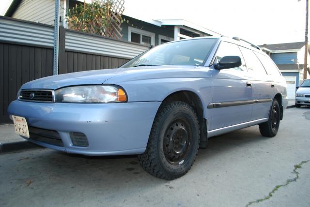

venicebean Posted March 10, 2011 Author Share Posted March 10, 2011 (edited) tires installed: Edited March 10, 2011 by venicebean Link to comment Share on other sites More sharing options...
