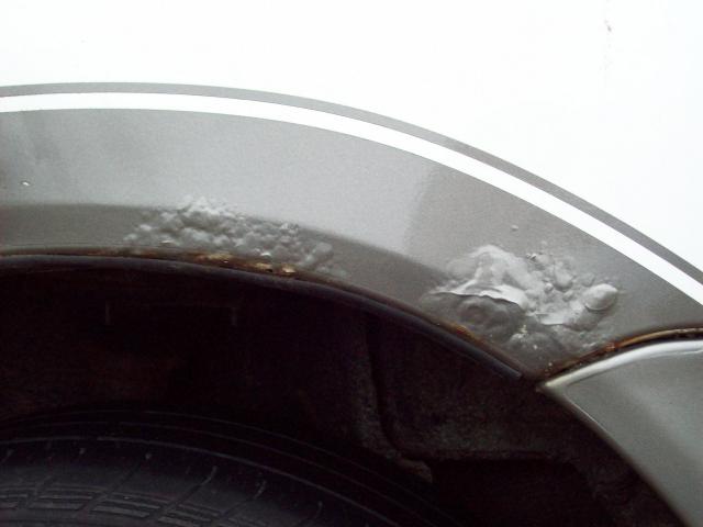

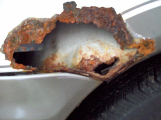

Looking to repair the rust on the rear quarter panels on my 96 Outback. After digging into the passenger side rust, there is a hole the size of a softball that needs to be repaired. The car came from the mountains of Pennsylvania, so all that road salt ate the rear quarters up. The driver side is not as bad, but it needs to be repaired also. Fortunately, the underside of the car is pretty much rust free. What would you guys recommend doing to fix this? I was thinking about using a fiberglass cloth kit. Since the car is white, it shouldn't look too bad if i paint the area myself after the repair. Also, what is the exact color of the grey striping on the Outback models? I'm hoping this will be an easy fix. I still have to do head gaskets on this car and the Duty C solenoid replacement. I'm on the fence right now as to whether the car is worth fixing or if I should just junk it and get something in better shape. It has 142,000 miles on it. Thanks for your help.

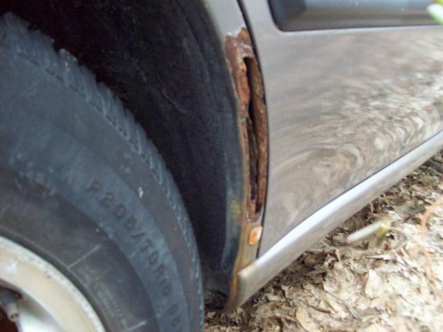

It would be nice if there were patch panels available for the Outback. I've been searching for some, but haven't been able to find any. The portion that is rusted out is the rear fenders right above the bumper cover. The passenger side is also rusted out in the wheel well area just behind the rear door. Subaru360, I like your idea of cutting out rust-free sections from junkyard cars. What do you use to cut out the sections?

Ive done 3 rust repairs in this area of the 90's cars. The procedure is cut, fiberglass, bondo a few times, and paint. You can get it as smooth as you want with the bondo, sand, bondo etc. The only thing that I have learned is that if there is a 1/2" rust hole, then cut a 3" hole out. You have to get rid of the partially rusted area or the rust will be back in a year.

you still got more rust to cut out. pull the interior plastics, trim pieces.
pop rivot som sheetmetal from the inside (license plate, old scrap metal etc). Then skimcoat it with bondoglass or kittyhair.
Sand smooth.
finish off with primer sealer coats, then some good paint. gotta appreciate the rust free ones when they show up.
