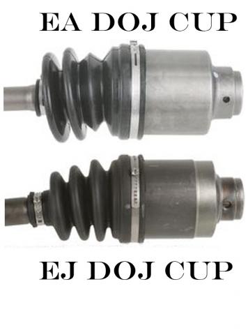

xbeerd Posted March 9, 2011 Share Posted March 9, 2011 or chop in a weheel well, since yours is made of fiberglass and por-15 LOL. just caught that. anyways.. as far as the axles. overall length, the EJ is a shorter axle probably due to a wider transmission. but here is an external comparison of the 2 doj's Link to comment Share on other sites More sharing options...
