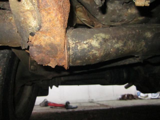

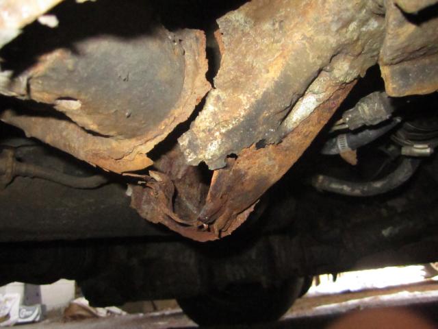

mickytrus Posted March 17, 2011 Share Posted March 17, 2011 Hi This might be it(funeral services) for the car.... 285k It is a 91 subaru Loyale wagon was hoping I would get to 300k I have the spare parts, so it would just be labor... Here are the details. The rear passenger wheel leans in at the top..... I had to drive at 40 miles perhour... for 200 miles. to get home....... I brought it into the garage...... to check out the problem...... If you want to call it the lower rear cross member... maybe that describes it well enough..... basically this is the part which runs from wheel to wheel and the lower control arms connect to. (when I put jack stands under the car to support the car this is where I hold the car up... It is tubular in shape and hollow.... Well, It snapped... seems to have rotted out from the inside out.... So the question... is... Has anyone ever replace one of these.... basically, the whole rear suspension has to be pulled out. (or a good chunk of it) Like I said, I have an extra one.... just wonder if I should do it...... I am a glutton for punishment..... This can be seen by trying to get 300k out of the car Thanks, Mickytrus Link to comment Share on other sites More sharing options...

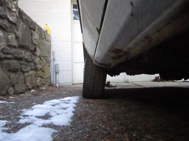

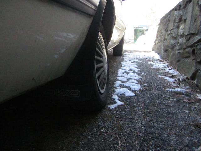

mickytrus Posted April 1, 2011 Author Share Posted April 1, 2011 (edited) here are some pics of the break. I had mentioned I would post them.... good to see what/how they can break. As for the car... Yeah, that is a good optimistic approach. work on it for an hour and see what happens....... I ended up getting another loyale... Out of RI.... 3 hours away.. this means I have four of them in my yard now....... I'll post a pic of the "ho's". It would be cool to get another 15k on the car.(her name is Trixie).. she would have 300K... that was the ultimate goal... . I seem to be having trouble with the Image attachments..... more pics Edited April 1, 2011 by mickytrus Where are the pics? Link to comment Share on other sites More sharing options...
