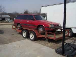

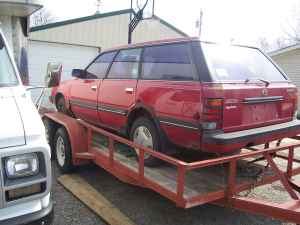

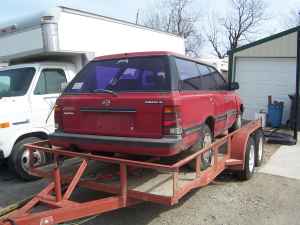

Can anyone guess the year of this car. This is what the ad said:
87? Subaru 4WD
No title or key. Ran when parked, was told needs brake work and exhaust was noisy. New tires (13"), needs cleaning, not pretty.
Im guessing 90 or 91...

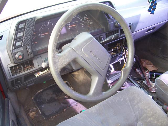

'89 or older - it's got a Dual Range. Specifically it's an '87 to '89 because of the dash and steering wheel style.... and lack of automatic belts..... hard to say which of those years as they were all very similar.
13" wheels and tires are standard on all EA series vehicles. Anything larger is VERY rare. A few examples have been found but they literally number less than a dozen sets that I've witnessed as factory EA wheels or optional wheels. Pug's not included of course....
GD
Edited by GeneralDisorder

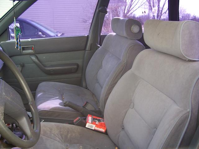

This car is a 1987 with gl-10 seats.
the steering wheel is 1987 specific. 85-86 was more squarish, and 88 thru the loyale had the long horizontal middle, the dildoey steering wheel.
1987 is somewhat specific to its year, as this was a tansition year. The wiring harness is schematically similar to a 1988, but has connectors similar to a 1986. The sensors and distributor are compatible with 86.
by 88, the design remained considtent through the 1994 loyale.
The instruments have a green illumination.
if you replace your engine, the harness form the intake will swap over to an 88+ manifold, and the manifold itself swaps. The connector for the engine harness is similar to 1986. If you use a motor from 88 or later, you need your original intake, or at least swap your87 harness to the 88+ intake.
The GL-10 was the luxo trim package, and the seats were more plush with velour and the buttons, where the regular gl had more of a tweedish type fabric.
the gl-10 seat has a height adjust lever on the side. pulls up or down, extends for leveage.
