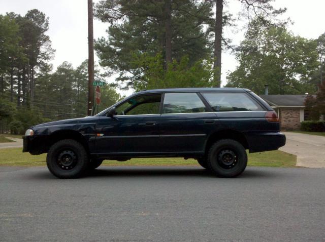

:banana:havent been on in a while cause my soobie is better than ever. thanks for all the help! now my 97 legacy L wagon 2.2 has a SJR 3" lift, new 28" tires, new outback struts and springs, a new knock sensor(which made a huge difference), free flowing 2nd cat with no guts, and best of all. no torq bind! thanks for the help on the duty c solenoid. now that ive done it i like to tell anyone needing to do it. go for it! its very straight forward and simple. just pay attetion and keep ************ clean. it did help that my tranny was dropped 3" by my lift. didnt have to lower tranny or anything. had all the room in the world to do the "surgery". im trying to get some pics on here. almost forgot about my custom front bumper. rear bumper being planned out. along with skid plates and a snorkle.
