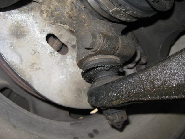

Dallasooby Posted April 10, 2011 Author Share Posted April 10, 2011 I think i almost got er fixed. I replaced the cv axle today again, got some MOOG ball joints.. the passenger side (old one) was ok, the driver side was really bad !! I cut open my knuckle and broke a finger gettin the darn thing off...it was stuck bad and had a 1/4 inch movment in it.... i finnaly got it back together and the test drive was soooo smooth... no shaking in the steering wheel.. no rattle.. no cluncks... still need some tie rod ends,, but they are ok for a few hundred miles... Link to comment Share on other sites More sharing options...
Dallasooby Posted April 10, 2011 Author Share Posted April 10, 2011 Passenger side i think.. looks good ..lol Link to comment Share on other sites More sharing options...
