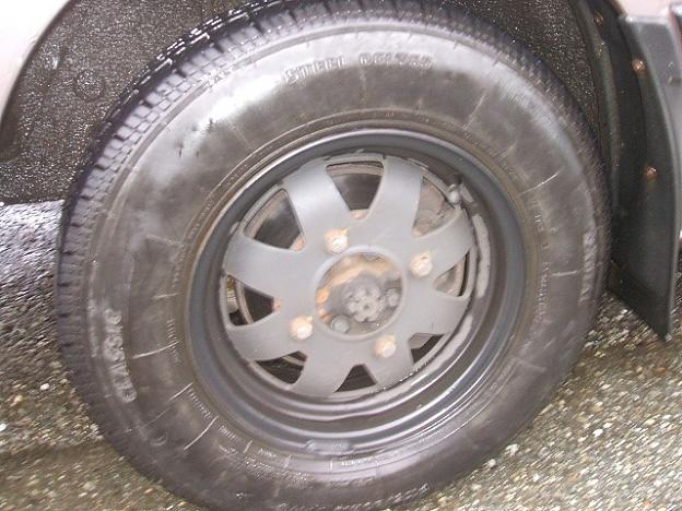

Deener Posted April 21, 2011 Author Share Posted April 21, 2011 Nope, none of the above. This one would have been a long shot to guess this one without seeing. I rebuilt/regreased one of the calipers, and then turned the rotor around without issue. Next I put on the rim and spun it again and it kind of hung up, so next I tightened the rim and then it wouldn't budge! The proverbial light bulb illuminates...the reason it's binding is because I have the black 'Wagon Wheel' rims below installed. The old pads were worn enough to allow the outside of the caliper enough clearance for the rim 'spokes'. But the new pads (Bendix D311IQ) were too thick and thusly pushing the calipers outwards on the silde pin enough to hang up on/rub the rim. These Bendix pads are the correct pads for a 93 Loyale BUT they are roughly 2-4mm too thick to use with my black rims. Since I don't care about the rotors I shamefully loaded the outside pads into the vice, put on my eye wear and ground them down about 5mm which was enough to give me clearance. Bled them all the way around with fresh fluid and it's rolling smooth again, brakes work great. So that leaves me with a couple of questions... Since grinding down pads is not the smartest thing to do, does anyone know if there are any lower profile pads around that would do the trick? I thought about making an adapter plate for the hub maybe, but I don't want to sacrifice any structural integrity....? Oddly the white rims I show here below fit my 88GL without any rubbing whatsoever, yet the black ones on the 93 Loyale rub the rims really bad. Were the 88GL calipers smaller than the 93 Loyales? If not then I must have obtained smaller pads for the 88. Link to comment Share on other sites More sharing options...
