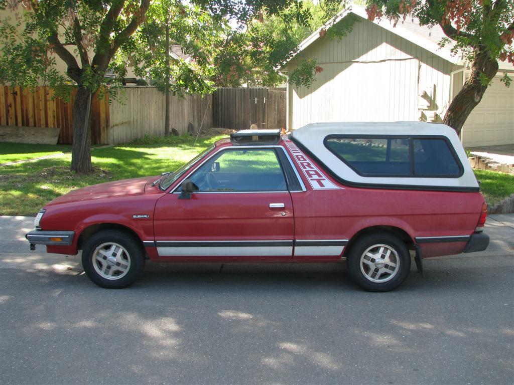

RedBrat Posted August 17, 2013 Share Posted August 17, 2013 (edited) I have just read this entire thread. The OP has done a tremendous job with his Brat. I compliment him on his perserverance and his troubleshooting skills. I also want to compliment his parents for having brought him to this point. It didn't happen by accident. Yes, there is something about Subaru's in general and Brats in particular that can become addictive. I purchased my original Brat about 10 years ago and about a year later was able to secure my present Brat. It is bone stock. Keep up the good work and keep working on the rust and other little things as time and money allow. I have copied a few posts from this thread and saved them for my future reference. Mine serves as a tow vehicle behind my motorhome and as a fun casual driver. You have reindpired me to do a few more things to mine. I have subscribed to this thread so keep it coming. Edited August 17, 2013 by RedBrat Link to comment Share on other sites More sharing options...
