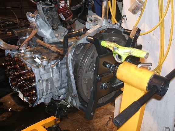

Deener Posted May 25, 2011 Share Posted May 25, 2011 I could only find one bolt long enough for the top so I improvised and used a gullwing truck from an old skate setup in the picture. The engine held fine with just the top bolts in and I am able to spin it upside down with out any issue. If anything, it rocks into place once you spin it back around but it is still fairly solid... Link to comment Share on other sites More sharing options...
