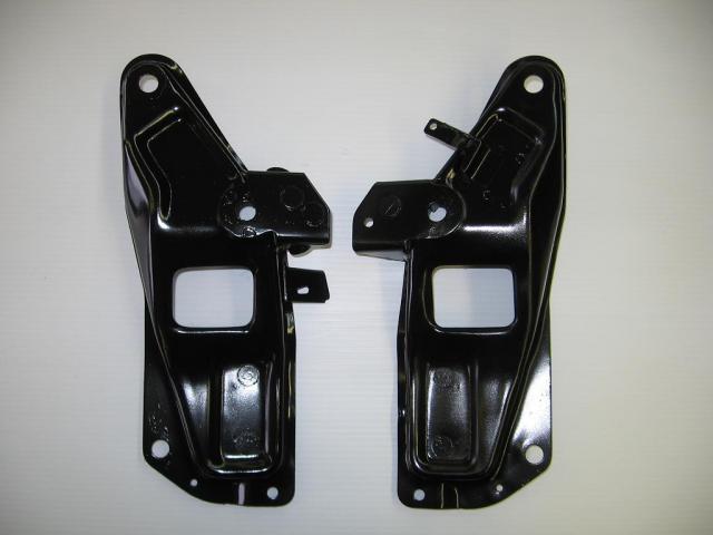

Crazyeights Posted July 10, 2011 Share Posted July 10, 2011 It seems to me that the radius arm plates for an automatic car do not have the mounting tabs for the 4 speed crossmember. I remember having to find and swap them when I did mine. Just another small detail that can be a pain if you aren't prepared for it. Quote Link to comment Share on other sites More sharing options...
Red0ktober Posted July 10, 2011 Author Share Posted July 10, 2011 I don't know what the radius arm plate is... This is all I have of the 5-speed: Quote Link to comment Share on other sites More sharing options...
carfreak85 Posted July 11, 2011 Share Posted July 11, 2011 The radius rod plates are found on EA81s. You need the manual transmission version to replace your auto-specific ones. Quote Link to comment Share on other sites More sharing options...

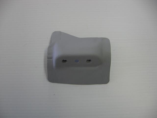

Crazyeights Posted July 11, 2011 Share Posted July 11, 2011 (edited) You will also need the small bracket that is spot welded to the floor on the inside of the trans tunnel (by the drivers seat) to mount your D/R shifter lever. The auto car doesn't have this either. Edited July 11, 2011 by Crazyeights Quote Link to comment Share on other sites More sharing options...
