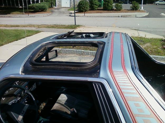

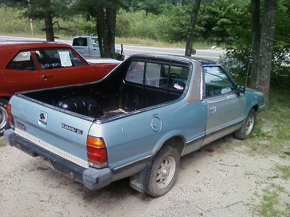

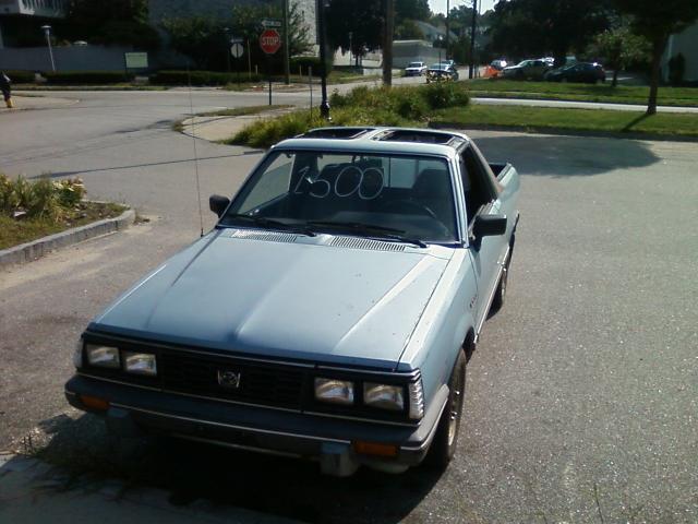

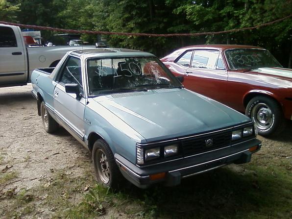

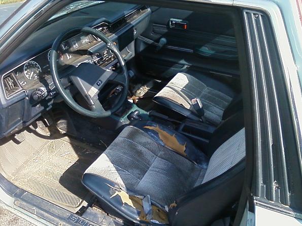

subie94 Posted August 6, 2011 Share Posted August 6, 2011 (edited) it's a 86 with a little under 128k,4spd with D/R 4wd,light blue with one silver door.rockers need some attention but body is in good shape.interior needs some work too (ripped drivers seat,loose dash pieces (but all there),radio works and i found a nice surprise in glove box..owners manual in really good shape. oh btw,for some reason the clutch pedal is pretty low,i barely have to push it down before it catches/releases clutch and also hits the floor..i really hope it's not cause clutch is just about gone.. Edited August 6, 2011 by subie94 Quote Link to comment Share on other sites More sharing options...

subie94 Posted August 6, 2011 Author Share Posted August 6, 2011 ok cool,thanks for the heads up about ordering parts.i may also need a speedo cable (haven't checked connection at trans yet) mainly cause speedo bounces quite a bit at slow speeds (bounces less at about 40,i think if it's working then) and odometer and trip meter isn't working.. (so basically it has more then the 128K but haven't a clue how much..) (maybe if i test drove it,i would of noticed the speedo,trip and odometer issue..) I drove it home (about 40min drive) and besides throttle cable/linkage sticking a bit (will idle up to about 2k while stopped and clutch in) and manifold gasket leaking (manifold pipe at bend) is banged pretty bad (probably caused excess pressure to blow out gasket) it ran and drove very well considering.. here's some more pics..i Love the T tops..(safety latch on pass side needs to be fixed (pin's not lining up) but i great shape.one back slider has been replaced with plexi..gonna need replacement before winter.. Quote Link to comment Share on other sites More sharing options...
