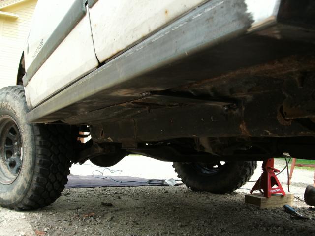

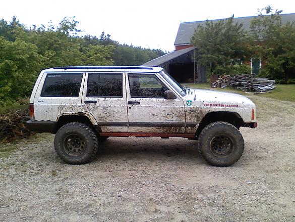

subie94 Posted August 7, 2011 Share Posted August 7, 2011 (thought i'd put this in the offroad section,but maybe belongs in different section) I did it on my Jeep Cherokee when the rockers were to rotted to be patched.i didn't know if anyone here has done it with a Subaru (or thought of doing it) Link to comment Share on other sites More sharing options...

subie94 Posted August 9, 2011 Author Share Posted August 9, 2011 El Presidente said: subie94: I really don't see why tube rockers wouldn't work, just make sure your at least a little good at welding sheet metal and be sure to watch your heat. I say go for it! i may just patch em for now and get with the guy that did the ones on my XJ.he does welding for a living but his personal welder is a small mig and when he did the xj,he used stick welding..and had issues burning through the thin steel along door sills.. only cost me about $200 (steel/labor) Link to comment Share on other sites More sharing options...
El Presidente Posted August 9, 2011 Share Posted August 9, 2011 subie94 said: i may just patch em for now and get with the guy that did the ones on my XJ.he does welding for a living but his personal welder is a small mig and when he did the xj,he used stick welding..and had issues burning through the thin steel along door sills.. only cost me about $200 (steel/labor) Don't use a stick welder on sheet metal, they need too much heat to operate and will blow through thin metal. That small mig should work great..Keep in mined your only welding metal thats 14-20ga.. I'd use a .023 or .030 wire and run %75 AR/%25 CO2 shielding gas. Don't forget to clean what your welding too, the caulks and sealers they use on autobodys smell horrible when welded and make for weak joints. I weld for a living too:grin: Link to comment Share on other sites More sharing options...
