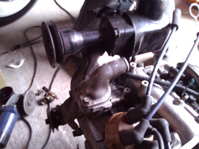

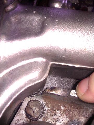

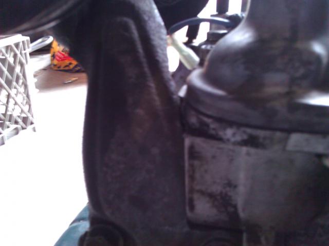

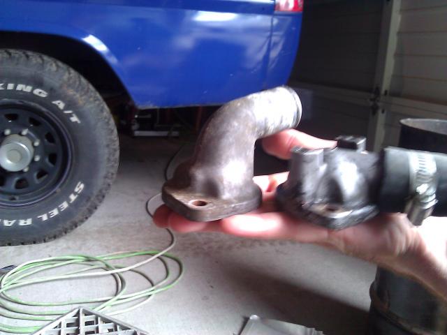

Naked Buell Posted August 10, 2011 Share Posted August 10, 2011 Here is some pics of the mod job I had to do. It's an Ea 82 manifold. I had to grind a sliver off the alt bracket, and a pretty good chuck out of the Ea 81 PS bracket. I put power steering in my Brat from an 84 turbo coupe. If u use the t-stat housing from the Ea 81, it is much taller that allows you to shoot it backwards and then u make a smooth transition back to the radiator. I know how you guys like the pics, like me, so here you go. :cool: Quote Link to comment Share on other sites More sharing options...

Naked Buell Posted August 12, 2011 Author Share Posted August 12, 2011 I wasn't doing a SPFI swap. I broke a bolt and then the extractor in the intake so I got another intake and to my surprise GD told me that an Ea 82 has better flow and will bolt up. So the mods are to get it to work. But I am sure the SPFI would work and open up more room on the other side of engine. Quote Link to comment Share on other sites More sharing options...
chad barker Posted August 21, 2011 Share Posted August 21, 2011 hello my name is chad and i am doing a complete engine swap from the stock 82 out of 87 gl wagon with an 84 year ea81 engine and the 82 intake, as i just made most of the mods (6) to things related so that it would simply bolt down. do you have any dvice or tips? my intake is still loose as we spaek but im wanting to get it bolted down and start the pain of figuring out what hoses and lines goe where as the 81/82 intakes/engines have similar parts and diffrent locations, if that makes sense. and what was the purpose of turning around the thermostat housing? ive had no trouble with this (yet) am i overlooking something important? and just so you know, i am after longevity nd reliability no high performance reasons here, so stock stuff is fine.thanks for help Quote Link to comment Share on other sites More sharing options...
Naked Buell Posted November 12, 2011 Author Share Posted November 12, 2011 The reason for turning the t-housing around is because with PS, you run right into the belts, but if you don't have PS, you probably don't have to swap that out. :cool: Quote Link to comment Share on other sites More sharing options...
GeneralDisorder Posted November 13, 2011 Share Posted November 13, 2011 (edited) Yeah that's a great idea actually. I also did the EA81T water pump, crank pulley, and alternator pulley in order to run the EA82 style power steering. It's nice not having that idler that sticks way down in the mud - but the EA81T parts aren't easy to locate. Mostly the crank pulley - water pump I bought new and the alt pulley from an EA82 works fine. Getting a cranky pulley though is no simple task. IIRC you also need the PS bracket. Though the pump from the EA82's works best so you can run the PS lines to the passenger side. Custom hoses were needed to interface the EA82 lines to the EA81 rack. GD Edited November 13, 2011 by GeneralDisorder Quote Link to comment Share on other sites More sharing options...
