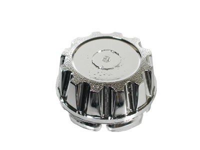

1982gl4 Posted February 26, 2012 Author Share Posted February 26, 2012 Hmm, probably a becoming hard to find wheel. I like the looks of them though! Paint caps FTW! Yeah I have only seen one other set on here. They remind me a bit of rally wheels, probably the reason I like them so much (and painted them gold) Turns out paint caps are too small for these wheels, so I'm going to put the wheels on and take some measurements (so I don't run into clearance issues with the cv nuts) and I think I'm going to be getting these, but in black as they make them in a 70mm size And I can pull some subaru emblems off from old center caps and epoxy them on Link to comment Share on other sites More sharing options...
TheLoyale Posted February 26, 2012 Share Posted February 26, 2012 Hmm, I wonder if these would pop into place on Steal pugs? If so, I want a set in Black for my EA82!! Where did you see these? Ebay? Yeah I have only seen one other set on here. They remind me a bit of rally wheels, probably the reason I like them so much (and painted them gold) Turns out paint caps are too small for these wheels, so I'm going to put the wheels on and take some measurements (so I don't run into clearance issues with the cv nuts) and I think I'm going to be getting these, but in black as they make them in a 70mm size And I can pull some subaru emblems off from old center caps and epoxy them on Link to comment Share on other sites More sharing options...
