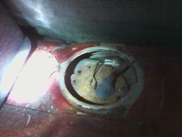

subie94 Posted October 7, 2011 Author Share Posted October 7, 2011 it sits/bolts to the top of the gas tank on drivers side.I'll see if one of the computers at work (which i'm on right now) will allow me to upload a pic and i'll try in a bit to come back and edit this with pic.. what is in question has one hose to it and a electrical connection. I got it taped up and jb Welded..drove to work and i can see that gas is seeping alittle out from under the P*** poor patch job.. *on a good note,i'll be picking up a factory multi cd player from a guy for $30 tomorrow night..* Quote Link to comment Share on other sites More sharing options...

subie94 Posted October 8, 2011 Author Share Posted October 8, 2011 This where it's leaking.it's some what patched so it's more of a very slight leak now.. Quote Link to comment Share on other sites More sharing options...
WoodsWagon Posted October 8, 2011 Share Posted October 8, 2011 There's two fuel level gauges, one for each sump of the tank. The average of those two readings is what the dash displays. The fuel returning from the fuel pressure regulator gets run through a nozzle in the passenger side sending unit of the tank before it dumps back into the tank. That nozzle creates a low pressure zone that sucks fuel from the auxiliary sender pickup (the pipe you see coming out of the drivers side) and transfers it into the passenger side, keeping the fuel pump submerged until the drivers side of the tank is empty. With the rust you have going on, you'll need to replace all the pipes on the body while you have the tank out. Do the rear brake lines at the same time too. It will be a ************-show of crumbling rust and breaking bolts. Quote Link to comment Share on other sites More sharing options...
subie94 Posted October 8, 2011 Author Share Posted October 8, 2011 There's two fuel level gauges, one for each sump of the tank. The average of those two readings is what the dash displays. The fuel returning from the fuel pressure regulator gets run through a nozzle in the passenger side sending unit of the tank before it dumps back into the tank. That nozzle creates a low pressure zone that sucks fuel from the auxiliary sender pickup (the pipe you see coming out of the drivers side) and transfers it into the passenger side, keeping the fuel pump submerged until the drivers side of the tank is empty. With the rust you have going on, you'll need to replace all the pipes on the body while you have the tank out. Do the rear brake lines at the same time too. It will be a ************-show of crumbling rust and breaking bolts. ok so the item in pic isn't pressurized but a vacuum suction.. yeah,not looking forward to tank removal and such (that is if i'm not the one that physically does it) Quote Link to comment Share on other sites More sharing options...
