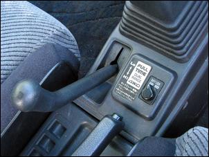

soobie_newbie67 Posted October 6, 2011 Share Posted October 6, 2011 i was googling and found this very awesome dual range transfercase. its full time 4 hi with the locking center diff switch, but also has a low range. i want to get ahold of one of these. Quote Link to comment Share on other sites More sharing options...
Turbone Posted October 6, 2011 Share Posted October 6, 2011 Yes, the later RX's had them. Quote Link to comment Share on other sites More sharing options...
TheLoyale Posted October 6, 2011 Share Posted October 6, 2011 Yes, the later RX's had them. If I'm not mistaken, the XT6 has this too? Quote Link to comment Share on other sites More sharing options...
Turbone Posted October 6, 2011 Share Posted October 6, 2011 If I'm not mistaken, the XT6 has this too? No, the XT6 does not have a D/R in it, just fulltime 4wd. Fulltime D/R didnt come out till 88 in the RX 3dr and 4dr. Quote Link to comment Share on other sites More sharing options...
GeneralDisorder Posted October 7, 2011 Share Posted October 7, 2011 Some wagons also had them but it was rare. It's a standard 5MT D/R with a locking center diff. The low range is only 1.2:1 and the final drive is 3.7:1 so effectively if you put them in low-range they have the same gearing as a "normal" 1.59:1/3.9 D/R has when in high range. So pretty useless except on a very small range of builds (lower end of the performance spectrum and with a "street" setup) or as a platform for building special transmissions using parts from a normal D/R and the XT6 R&P to get a 3.9 final and 1.59:1 low w/locking center. GD Quote Link to comment Share on other sites More sharing options...
