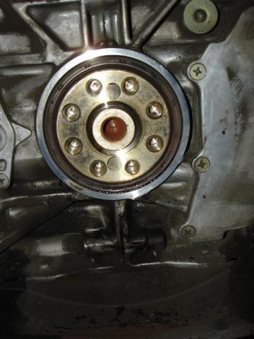

hohieu Posted October 19, 2011 Author Share Posted October 19, 2011 I took the flywheel and here's the deal. I have the metal oil separator cover, which I'll reaseal. But my rear main seal is seeping/weeping. I wiped some grime of the bottom of the seal to get a better look, and it doesn't seem too bad. The lip was still soft and pliant. I already have the seal so one last time here: should it stay or should it go now? Quote Link to comment Share on other sites More sharing options...
ShawnW Posted October 21, 2011 Share Posted October 21, 2011 I would replace that one. Quote Link to comment Share on other sites More sharing options...
