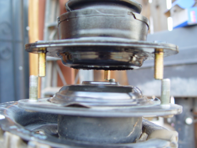

blk99obs Posted November 13, 2011 Author Share Posted November 13, 2011 Well now I have a problem... went to put the 03 fozzy stuff on today and found that one of the rear struts was all messed up, looked like someone didn't tighten it down all the way or something because the top hat was all wallowed out about an inch sideways where the strut goes through it and the threads for about half the threaded portion were non-existent. I also went to the parts store and they couldn't find/didn't have the rubber piece that the spring sits on under the top hat, though they did have the top hats... Guess I'll have to go back to the pick and pull and see about trading for some different ones... Think they had a 99 foz there but no more 2nd gen... I want the 03! grrr! Link to comment Share on other sites More sharing options...
Ioku Posted November 13, 2011 Share Posted November 13, 2011 that rubber thing that goes in the spring perch isn't that important ive throne them out before because they always fall apart, this just to help with noise but even with out them I've never noticed any more noise. and as for spacers I think the most you can run is 5mm before you need longer studs. Link to comment Share on other sites More sharing options...
