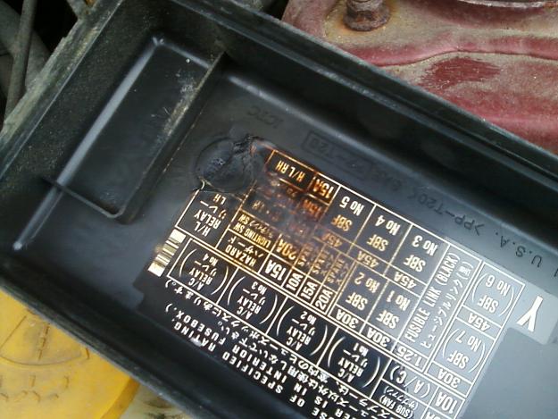

subie94 Posted October 28, 2011 Share Posted October 28, 2011 And started to melt the plastic cover.previous owner said he had alt/battery replaced when alt fried (which also damaged something in the gauge cluster,which was also replaced) jacket on fusable link looks discolored but not melted..Just the black plastic cover of the box link is in.. besides the stock radio losing half the lights and most of the lights out for climate control,no electrical issues to speak of..should i replace the fusable link to be safe or should i not worry right now ? (i'll try and get pic tomorrow) Quote Link to comment Share on other sites More sharing options...

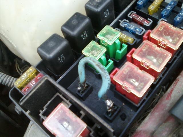

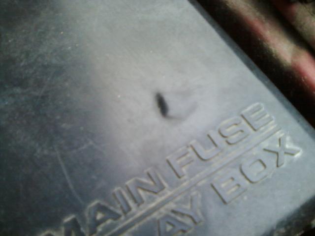

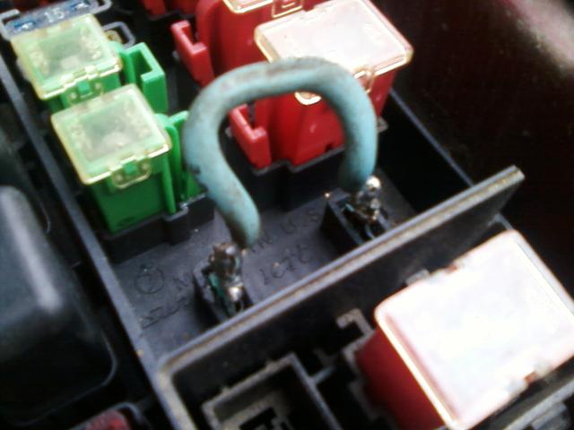

subie94 Posted October 29, 2011 Author Share Posted October 29, 2011 (edited) I'd replace the whole fuse box. It's not good if the box gets hot enough to melt and the link doesn't blow, that's a disaster waiting to happen. only spot on box that melted was a tiny spot just above link.looks like the bend in the link was in contact with cover.and isn't the wire supposed to be black..mine is kinda teal (blue) will have to look into cost of new box anyway.. Edited October 29, 2011 by subie94 added pics Quote Link to comment Share on other sites More sharing options...
Fairtax4me Posted October 29, 2011 Share Posted October 29, 2011 (edited) Oh so it melted the top cover of the box? I was thinking it melted the bottom part where the connectors stick up. That could have just been from the link getting hot and blowing. Probably happened because of the alternator problem. Pics help a lot! What's in there now is a wire, NOT a fusible link. You need to replace with the proper link that ASAP. Junkyard is your friend. I might have one I could send you if you can't find one at a pik'n'pull. I know I had one floating around somewhere but I'll have to look to make sure I still have it. Worst case those are about $10-$12 new at a dealer. Part number: 82301GA060 http://www.subarupartsforyou.com/cp_partdetail.php?partid=15264 Edited October 29, 2011 by Fairtax4me Quote Link to comment Share on other sites More sharing options...
subie94 Posted October 29, 2011 Author Share Posted October 29, 2011 (edited) ah ok..Thanks for the heads up about it just being a wire..thought i smelt a wiring burning the other morning but couldn't pin point where.. i wonder if the one from my 94 would work.( pulled everything from the box when i scraped it..now if i could find it **Found it** ) I just hope the wire wasn't put in there cause something kept popping the link.. Edited October 29, 2011 by subie94 Quote Link to comment Share on other sites More sharing options...
subie94 Posted October 29, 2011 Author Share Posted October 29, 2011 Swapped out the one from my 94 and it seems to be doing ok.. Quote Link to comment Share on other sites More sharing options...
