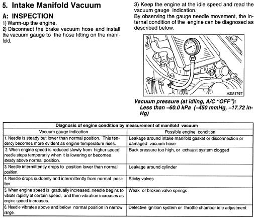

jarl Posted December 5, 2011 Share Posted December 5, 2011 - "Weak or broken valve spring" - "Defective ignition system or throttle chamber idle adjustment" (image from jdmfsm) Link to comment Share on other sites More sharing options...
