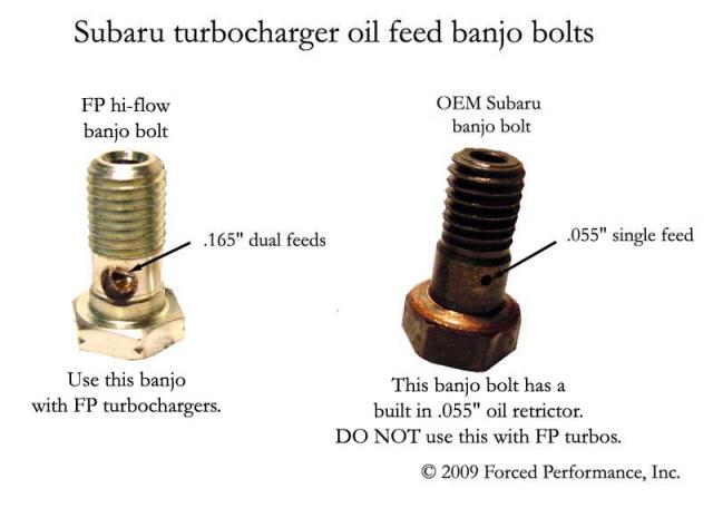

92svxman Posted February 15, 2012 Author Share Posted February 15, 2012 I came across some TSB one of which seams interesting to me about turbo banjo bolts. When I took off the banjo bolts i found one of the smaller hole ones, which means the turbo's don't/can't get all the oil needed and burns them out. I wonder if this is a repair the SOA should be doing on all turbo? Link to comment Share on other sites More sharing options...
Fairtax4me Posted February 15, 2012 Share Posted February 15, 2012 It's probably that way to limit oil flow in the turbo, and keep pressure up in other parts of the engine. The turbo is fed by the same gallery that feeds the camshaft and rockers in the passenger side head. If too much oil is allowed to flow into the turbo, the camshaft may be starved and seize, which is a much more damaging condition than worn bearings in the turbo. Link to comment Share on other sites More sharing options...
92svxman Posted February 16, 2012 Author Share Posted February 16, 2012 Hey John i do understand that the oil is needed to cover all moving parts, used to work on airplanes and was the same. Getting too little oil to parts that are high R.P.S. is going to burn up the turbo, and its Subaru short coming in there design of the oil line and banjo bolt size, the rest of the banjo bolts have openings of .165 and the turbo's banjo bolt is only .055. How many turbo's have been burned out because of this, and we as the drivers have to spend big bucks to get them fixed when it should be Subaru covering the coats. Link to comment Share on other sites More sharing options...
