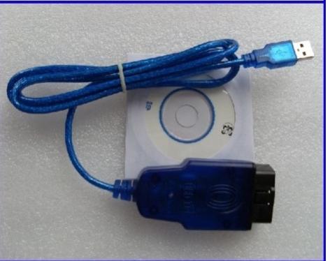

I got a USB to OBD poort cable from DX (deal extreme) for about 10 dollars. This cable so called VAG-com cable supports the KKL (http://www.dealextreme.com/p/usb-kkl-vag-com-409-1-compatible-interface-for-vw-audi-seat-skoda-120cm-length-37635)
Therefor works with Free SSM (http://developer.berlios.de/projects/freessm/) and I got it working with romraider for datalogging.
This on my EU 1999 impreza with a 1.6. US models are better supported.
ecuEDIT is non-free software which works as well.
Basically I can:
read and remove storred error codes (freeSSM)
view real-time ECU values (freeSSM and romraider)
log ECU values to a file (romraider)
