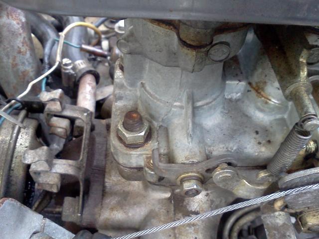

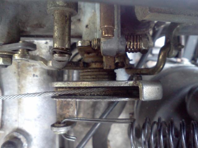

trucking45 Posted January 22, 2012 Share Posted January 22, 2012 Okay so today me and my step dad where using some carb and choke cleaner today and he noticed the secondory wasn't working even at higher rpms it wouldn't work he had to manualy work it...so how does it normally work? If you need better pics just let me know Quote Link to comment Share on other sites More sharing options...

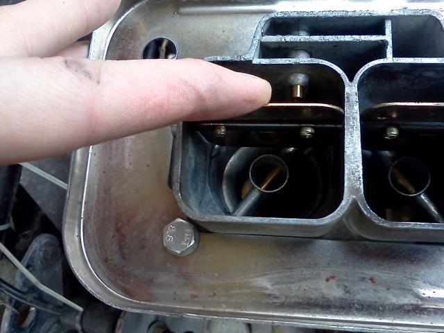

TeamCF Posted January 22, 2012 Share Posted January 22, 2012 The secondary is not really RPM/vacuum dependent on the Weber 32/36. Its throttle position dependent. I'd have to go out and look but I think it's about 2/3rds of the way to full throttle and it'll open using the linkage you posted in your first pic. Even with the engine off, if you push the pedal all the way to the floor it should open. If it's still not opening then it's possible something is not catching right in the linkage between the two. Looks right to me in the pics (as in nothing missing). But a more trained Weber eye might catch something I'm missing. The part you are holding open in the center pic is the choke. The first pic shows the link that opens the secondary. (Just to make sure we have things clear. ) Quote Link to comment Share on other sites More sharing options...
