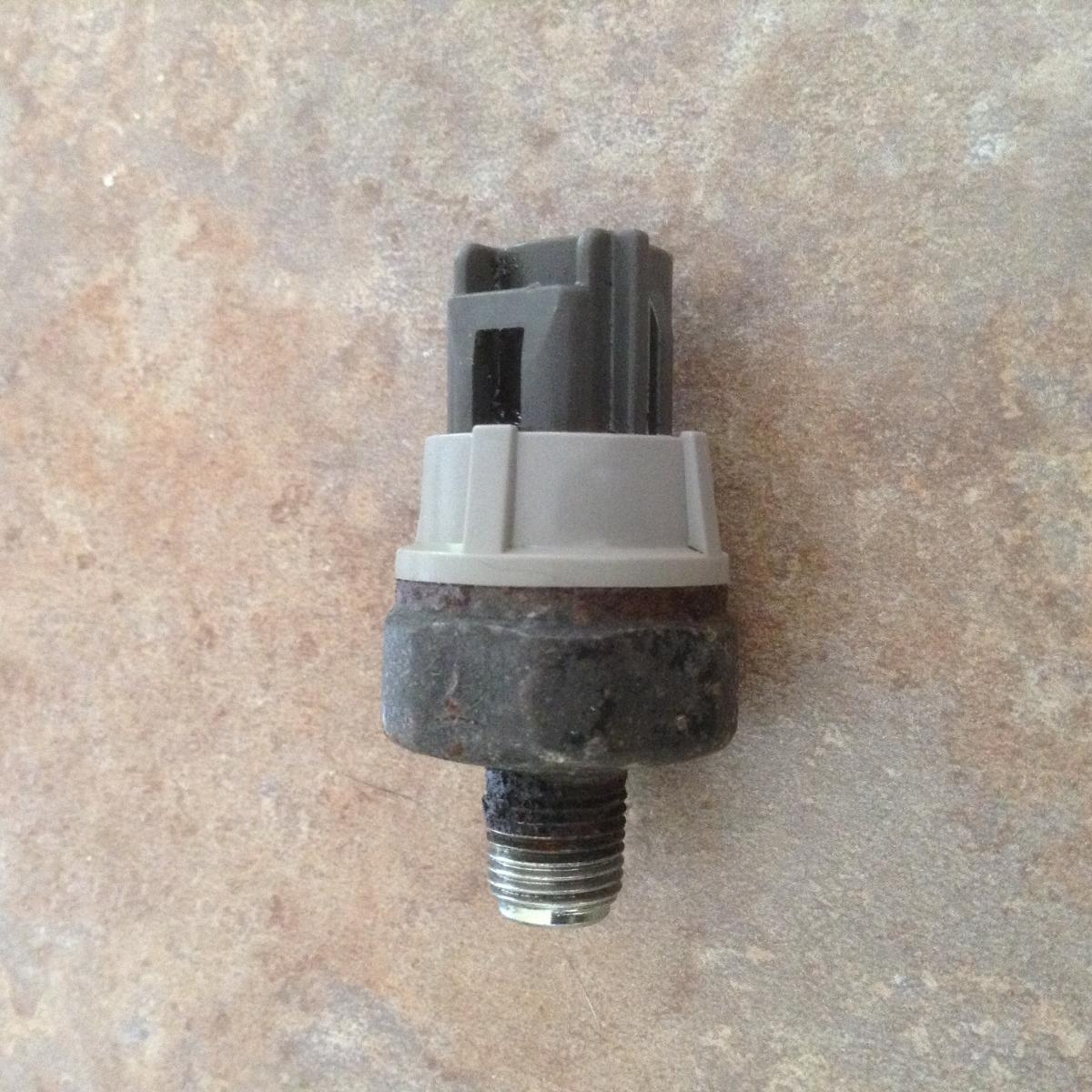

scottsheppard@videotron.ca Posted June 25, 2015 Share Posted June 25, 2015 Turns out I am likely ok...this little bugger was the culprit spraying oil everywhere. Looking thru the access hole on top of tranny, the inside looks dry and no oil... Link to comment Share on other sites More sharing options...
