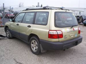

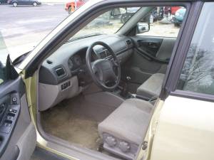

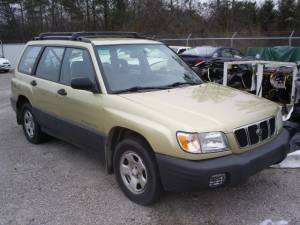

bhazard Posted January 26, 2012 Share Posted January 26, 2012 (edited) 01 Forester, 5sp, non-runner http://toledo.craigslist.org/cto/2817141100.html Got lucky, on a whim I checked craigslist for "Subaru" and it was right there, listed yesterday, its a dealer here in town where I live. I was there 15 minutes after I saw it, and made the deal pretty much right away. The guy pretty much let me name my price, and I said 700. I guess an 11 year old non-running car is worth nothing to a dealership lol... So this is an EJ251 then right? Any ideas what could be wrong? Everything on this car looked STRAIGHT. The body is near perfect, the interior was a little dirty but nice, under the hood looked decent too. I saw nothing wrong. When I hit the starter it just clicked like the battery didnt have enough juice to crank. Im hoping worst case is a broken timing belt, bent valves, I can just throw the heads from my OBS on an have a frankenmotor... I really dont feel like digging into a full engine swap in the middle of the winter. The dealership had no idea what was wrong other than they were told the engine is "bad". They said it was just hauled in off the turnpike. EDIT: They already took the posting down. I saved the pics though... Edited January 26, 2012 by bhazard Link to comment Share on other sites More sharing options...
Fairtax4me Posted January 27, 2012 Share Posted January 27, 2012 Yeah someone probably popped a timing belt and just had it dragged to the closest dealer and traded it in. Dealer probably gave them $300 for it and figured they could sell it quick locally or send it to auction and still make the money back easy. Not enough profit margin in it for them to pay a bunch of money to get it fixed. Great deal for you though! Link to comment Share on other sites More sharing options...

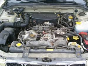

bhazard Posted January 27, 2012 Author Share Posted January 27, 2012 I dont think Im gonna get the easy break here. If I rock it back and forth in gear I can hear a bit of a clank coming from the bottom end, as if theres a broken rod flopping around in there. There was also an empty jug of oil in the back. A one gallon jug. The crankcase is overfilled, way overfilled. So who has a spare EJ251 longblock collecting dust? Link to comment Share on other sites More sharing options...

Rooster2 Posted February 2, 2012 Share Posted February 2, 2012 You posted that the engine was over filled with motor oil. I am wondering maybe the engine used some oil, so owner carried a large can of oil to add on a road trip. Maybe the owner forgot to add oil, and so ran out of oil, and locked up the engine, then added too much oil in hopes of getting the car to run again...with no success. Well if it were an out of oil problem, or timing belt problem, I think you made a good choice to replace the engine. With 204K miles on the odo, it is better to go with a replacement engine. Have fun with your new Subie!! Link to comment Share on other sites More sharing options...
bhazard Posted February 2, 2012 Author Share Posted February 2, 2012 Yes there was an empty 1gal jug of Chevron delo in the back. And lots of directions to places in Wisconsin. So im sure theres a lot of highway miles. Timing belt looks good though. The car seems fairly well maintained other than the blown motor. Link to comment Share on other sites More sharing options...
Rooster2 Posted February 2, 2012 Share Posted February 2, 2012 Yes there was an empty 1gal jug of Chevron delo in the back. And lots of directions to places in Wisconsin. So im sure theres a lot of highway miles. Timing belt looks good though. The car seems fairly well maintained other than the blown motor. Since the timing belt looks good.........I got to thinking.....Subies don't burn oil, even with 200K on the odo, so if the car used oil, it would be more then likely that there could be a major oil leak somewhere. I have seen where oil filters, or the pan bolt weren't tight to cause a major oil leak. The result is a seized motor, that won't turn over, and I remember you saying the motor will not turn over. Is the bottom of the motor covered in leaked oil? Just curious?? Link to comment Share on other sites More sharing options...

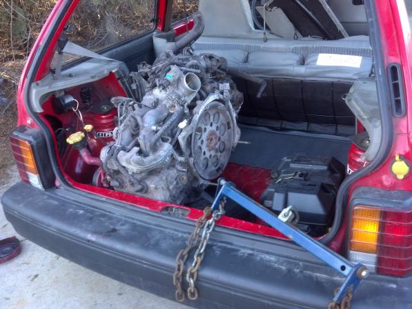

bhazard Posted February 5, 2012 Author Share Posted February 5, 2012 Brought my replacement EJ25 home today. Festiva ftw. Timing belt is a Gates and looks pretty new, so I think I'm gonna run with it. Maybe check the idlers and water pump and see if they've been replaced as well. Link to comment Share on other sites More sharing options...
1997reduxe Posted February 9, 2012 Share Posted February 9, 2012 wow, look how small that engine is... let us know when you get it running, ok? Link to comment Share on other sites More sharing options...
Fairtax4me Posted February 10, 2012 Share Posted February 10, 2012 Yep, they're kinda tiny. The block by itself you can pick up and carry around without much trouble. Festiva! I drove one of those for a few months. It was a go cart with a tin shell, it was so much fun to drive! It would burn clear through third gear in the rain. Link to comment Share on other sites More sharing options...
