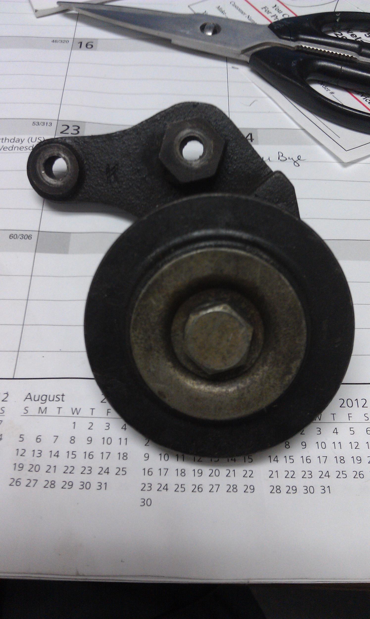

sunflowersubaru Posted February 3, 2012 Author Share Posted February 3, 2012 Here are some photos of my engine and the AC belt idler pulley. Mounting bolts are the long hex shaped bolt on the left and the partially threaded-in bolt on the right. When I spin the pulley I can hear it chirp, not short chirps but long chirps. The number on the back side of the bracket looks like 773003, but the last digit is not completely clear. Would like to pick up a spare idler pulley just in case. In the mean time I will give NAPA a call re the bearing. Thank you. Quote Link to comment Share on other sites More sharing options...
GeneralDisorder Posted February 3, 2012 Share Posted February 3, 2012 Standard EA82 AC tensioner - just replace the bearing and it will be fine. You aren't likely to need a spare in the car's lifetime. GD Quote Link to comment Share on other sites More sharing options...

sunflowersubaru Posted February 9, 2012 Author Share Posted February 9, 2012 (edited) Went to NAPA and they had the bearing. NAPA shop attached to the parts store installed the bearing for not much. Installed and it runs quiet. Have an extra bearing also just in case. Doubt the car will last long enough to use it. I'd still like to pick up an idler pulley just in case this one goes south and cannot be salvaged. Anyone recognize the idler pulley in the photos? Thank you. Edited February 9, 2012 by sunflowersubaru Update Quote Link to comment Share on other sites More sharing options...
