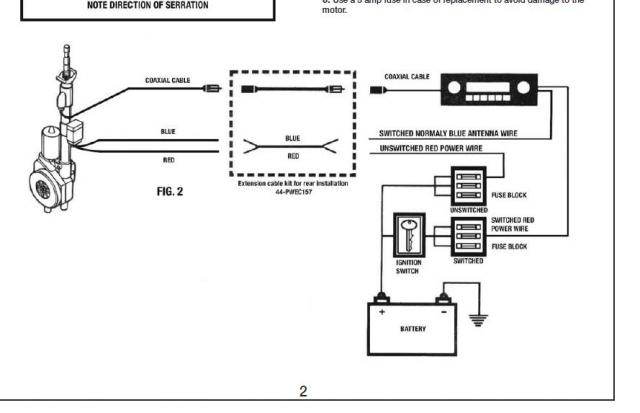

LeolaPA Posted February 8, 2012 Author Share Posted February 8, 2012 elogius it looks like the wiring diagram you supplied shows a "hot" wire, since it goes to a fuse, and a control wire, and I am posting a screen shot of a newer model of the same antenna, that shows a power wire and a control wire, so it looks like there would be no relay needed. If there was, these guys who make these antennas would have a lot of returns I would think, since that would be beyond the scope of most folks to figure out. Link to comment Share on other sites More sharing options...
eulogious Posted February 8, 2012 Share Posted February 8, 2012 elogius it looks like the wiring diagram you supplied shows a "hot" wire, since it goes to a fuse, and a control wire, and I am posting a screen shot of a newer model of the same antenna, that shows a power wire and a control wire, so it looks like there would be no relay needed. If there was, these guys who make these antennas would have a lot of returns I would think, since that would be beyond the scope of most folks to figure out. It must be grounded somehow though, to the frame or something, like McBrat mentioned. You need both positive and negative to make it work, so I would double check that once you get the unit But you are correct. Those are the two wires that you need. It wouldn't surprise me if they didn't tell you you needed a relay at all. In my remote start system (and keyless entry) I installed, it never mentions that I NEED any relays, just that they "might" be needed. Well, I had to install 6 relays to get it all working. So having a aftermarket manufacture not mention what you need is not uncommon at all, nor would I think they would take any unit back (after the normal return policy) because you didn't know how to install it, lol. Unfortunately this happens far more often than not with aftermarket stuff. Good luck with installing it, and if you need any more help, just ask! Link to comment Share on other sites More sharing options...
