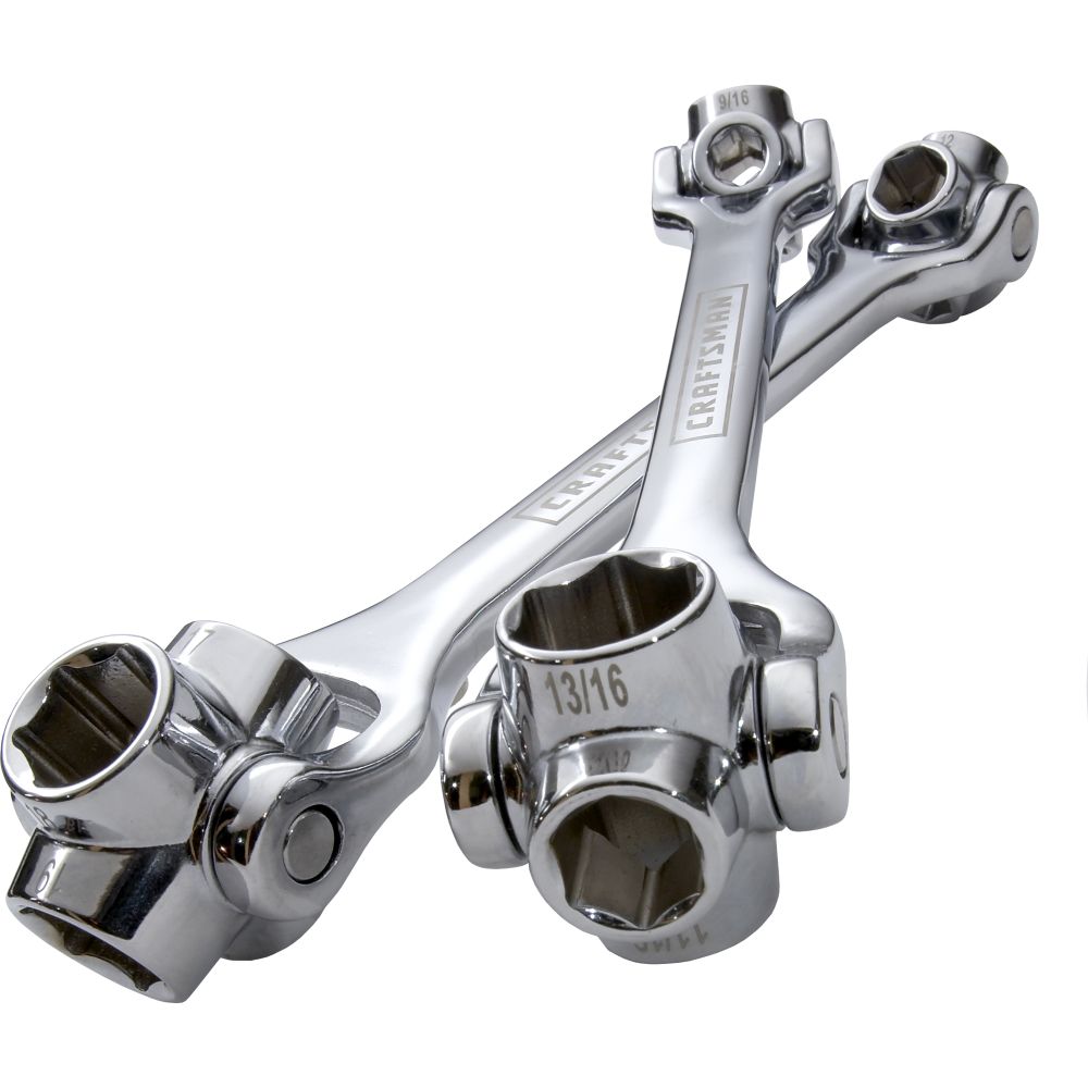

Durania Posted February 7, 2012 Share Posted February 7, 2012 (edited) I used a craftsman dog bone wrench before I got air tools. Picture shown is standard. I found the easiest way is just to impact them off. Make sure the spring is compressed first. You also need to pay close attention to the way the conical washer comes off. Here is the walkthrough to do them on an STi and they are extremely similar. http://www.iwsti.com/forums/how-install/85672-complete-idiots-guide-spring-installation.html Edited February 7, 2012 by Durania Link to comment Share on other sites More sharing options...
1 Lucky Texan Posted February 7, 2012 Share Posted February 7, 2012 (edited) I used a craftsman dog bone wrench before I got air tools. Picture shown is standard. I found the easiest way is just to impact them off. Make sure the spring is compressed first. You also need to pay close attention to the way the conical washer comes off. wish I had thought of using a dogbone wrench like that! That would have been a much more useful item afterwards and less hassle overall. Edited February 7, 2012 by 1 Lucky Texan Link to comment Share on other sites More sharing options...
