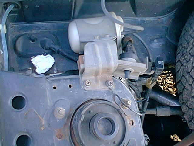

subiemech85 Posted March 24, 2004 Share Posted March 24, 2004 " why dont you remove the cannister?" found the cansiter in reference that you DO NOT remove that is the one in the pic remove the EMISSIONS canister Link to comment Share on other sites More sharing options...
iluvdrt Posted March 24, 2004 Author Share Posted March 24, 2004 i cannot remember if i have that one. if i do, then i just run the line from it to the vacume port, correct? thanks for the help. Link to comment Share on other sites More sharing options...
subiemech85 Posted March 24, 2004 Share Posted March 24, 2004 it is a vac reservoir, front line to controller, back line to intake manifold Link to comment Share on other sites More sharing options...
iluvdrt Posted March 24, 2004 Author Share Posted March 24, 2004 that will help very much. thank you. Link to comment Share on other sites More sharing options...
