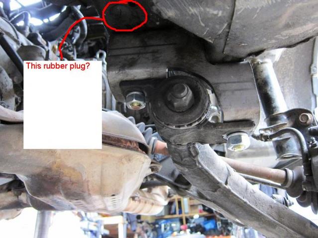

Scott in Bellingham Posted March 5, 2012 Share Posted March 5, 2012 Hey there, My buddy uwjberg and I are installing the 4" kit on our 91 Legacy this weekend and ran into a small snag. We can not figure out where this bracket goes. The other pics are of what we have going on now. Unfortunately, we did not get the directions from Scott and have not been able to reach him on the phone. The car has an auto tranny if that is pertinent. Let us know if you know where it goes or if you see we are doing something stupid. Any help is appreciated, thanks! JR This piece works at a 90 angle to the one in the following picture, there is a captive nut in the body( it may have a rubber plug in it as you have a automatic) in this pic below you can see the 2 parts sitting together how they mount, it add bracing to that arm mount Link to comment Share on other sites More sharing options...
uwjberg Posted March 5, 2012 Share Posted March 5, 2012 Thanks Scott - so does the a-arm bracket look like it's installed correctly? IE, the 'c' open towards the front of the car? Also - I know you mentioned that I need to flip a bracket underneath - something about the center dif maybe? The way I have it installed now the front driveshaft is rubbing a bit. Thanks again - I need to write it down next time! Link to comment Share on other sites More sharing options...
NorthCoast Posted March 5, 2012 Share Posted March 5, 2012 Makes sense now... if this plug is what you are talking about. Link to comment Share on other sites More sharing options...
uwjberg Posted March 5, 2012 Share Posted March 5, 2012 That's what I was thinking - but I think that means that the a-arm brackets are on the wrong sides (the open end would have to be towards the back for the brace to fit into it). Right? Am I crazy? Link to comment Share on other sites More sharing options...
NorthCoast Posted March 5, 2012 Share Posted March 5, 2012 That's what I was thinking - but I think that means that the a-arm brackets are on the wrong sides (the open end would have to be towards the back for the brace to fit into it). Right? Am I crazy? Yep. Need to switch sides. It will be much easier this time though. Link to comment Share on other sites More sharing options...
Gloyale Posted March 6, 2012 Share Posted March 6, 2012 Makes sense now... if this plug is what you are talking about. That plug is where the front trans crossmember would bolt on for a Manual trans. Link to comment Share on other sites More sharing options...
