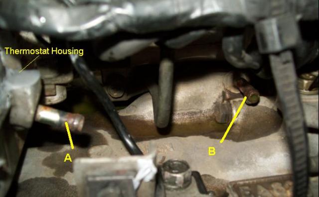

MR_Loyale Posted April 1, 2012 Author Share Posted April 1, 2012 (edited) I replaced the coolant bypass hose and turns out that wasn't it. So THAT hose will last another 20 years:D. I DID figure it out though. I have no idea what the hose is called, but is ia a 1/4 inch coolant hos that runs from the thermostat housing into either the block or the intake manifold - I cannot tell for sure. I am sure that is it because after I started it up, let it get warm and goosed the engine from under the hood, I saw little faithful erupting with each engine surge. If anyone knows what is the purpose of this hose, please let me know. I have no idea what it does or why it is there. It connects between points A and B in the image. The part guy at the Subaru dealership had a hard time even finding it in his catalog. There is no name given there either. Edited April 1, 2012 by MR_Loyale Link to comment Share on other sites More sharing options...
TomRhere Posted April 1, 2012 Share Posted April 1, 2012 I "think",,, it's to stir the coolant under the T-stat somewhat as the engine warms up. Only reason for that thought is where the T-stat is located, it's not really in a "coolant flow" position on a "cold" engine. So it would take a somewhat longer amount of time for the T-stat to "feel" any heat. But that's just my thinking...... With that said,, I have pulled the nipple out of the housing and plugged the hole, and plugged off the one on the manifold on 2 EA82 manifolds I've swapped onto EA81 engines. Haven't noticeed any detremental effects from doing that. But,,, you should be able to buy some 1/4" coolant hose from a local parts store to replace it with. Link to comment Share on other sites More sharing options...
czny Posted April 1, 2012 Share Posted April 1, 2012 (edited) My EA82 engine had a small leak from this "bypass" before I rebuilt it. Replaced the swaged tube with a 1/8" NPT 45*elbow & barbed fitting. The Edelmann # is for the elbow. Gotta be careful when you drill & tap the hole - keep the same angle as original & put a piece of hose over the drill bit for a stop to limit the depth. Maybe the purpose of this is to vent air from the coolant passages at the top of the block so there won't be any hot spots in the cylinder jackets. Edited April 1, 2012 by czny details Link to comment Share on other sites More sharing options...
Gloyale Posted April 1, 2012 Share Posted April 1, 2012 TomRhere said: I "think",,, it's to stir the coolant under the T-stat somewhat as the engine warms up. Only reason for that thought is where the T-stat is located, it's not really in a "coolant flow" position on a "cold" engine. So it would take a somewhat longer amount of time for the T-stat to "feel" any heat. But that's just my thinking...... It's not for stirring. The coolant crossover between the 2 block halves happens in a chamber at the top of the block. The hose connects to the high point in that passage. It allows any bubbles that would sit in that area to go up into the T-stat hosing and on to the radiator to vent out the cap. Probably not an issue to block it off, but it was put there for a reason......doesn't hurt to leave it and just put a new hose on it. 1 foot of 1/4 coolant line costs $.99 Link to comment Share on other sites More sharing options...
