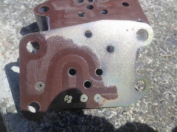

bluedotsnow Posted May 18, 2012 Author Share Posted May 18, 2012 (edited) I did not damage this in any way and was the condition it went into my used parts box. I would HARDLY call that reusable yet again I will say $100 clutch pack on a maybe, yet the dealer left out this ESSENTIAL gasket and plate. I don't care if they can be reused I asked for ALL THE PARTS! why reuse a few dollar gasket when you could use a new one!?! Edited May 18, 2012 by bluedotsnow Link to comment Share on other sites More sharing options...
GeneralDisorder Posted May 18, 2012 Share Posted May 18, 2012 But it came off clean on the other side. So you only needed the one gasket..... I can't rightly remember which one seems to always come off clean - but invariably one of them does. So I only end up using a single gasket. The plate is never replaced and is easily cleaned so I don't understand why you keep demanding that the dealer should have sold you this. It's not a wear item and as such is not stocked. The gasket.... eh.... I can make a gasket if I have to. Couple ball bearings and a ball-peen hammer. So they left out a $1 gasket. Big flippin deal man. The much bigger problem is the hack mechanics that didn't know what they were doing when replaceing the duty-c. And for that matter - it's the *solenoid* that goes bad (electrically) - the valve itself could simply be left in place and the new solenoid bolted to it. Though the dealer sells it with the valve attached so I generally replace both. But *if* I had a situation where I couldn't swap out the valve due to not having a gasket on hand I wouldn't think twice about snapping in a new solenoid and leaving the old valve body in there. I've never seen one of these valve bodys fail - just the solenoid itself. GD Link to comment Share on other sites More sharing options...

ivans imports Posted May 18, 2012 Share Posted May 18, 2012 thiss problem could have been traced with a preshure test gauge on tail section would have seen no prushure to awd and no varyance in preshure to awd or no loss of preshure when fwd fuse was installed has anyone tryed to modify thiss plate to incresae flow ? i took the whole valve assembly out and ran a line strait trough and works good [ race app] Link to comment Share on other sites More sharing options...
