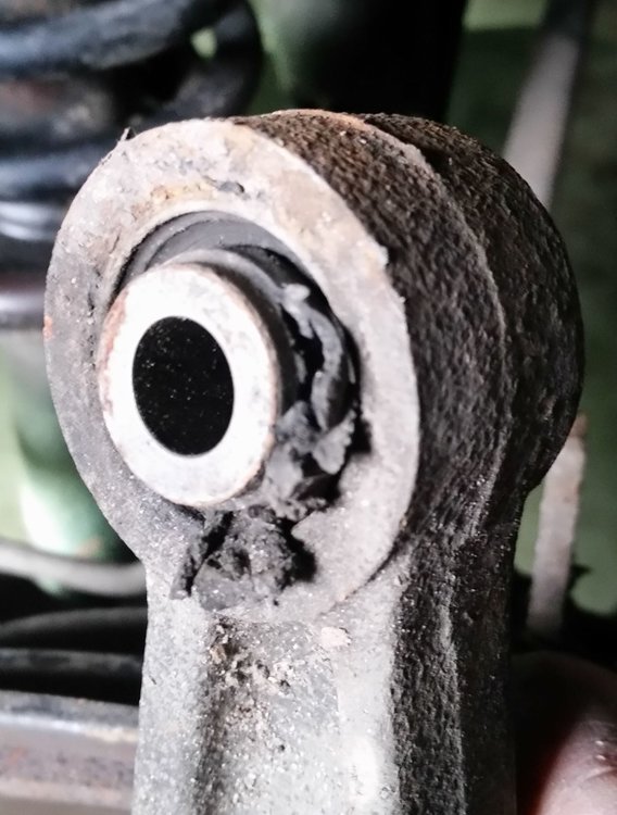

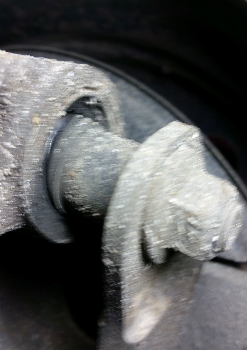

1197sts Posted December 18, 2018 Share Posted December 18, 2018 I am fighting a similar problem with my 2001 Outback, it gets very loose in the back end when I go over bumps. I was inspecting the rear suspension and I found what I think may be worn rear arm bushings. I am posting a picture can anyone give me some input on what this, I am not a suspension expert at all. How hard is it to change this if that's what I need to do? Link to comment Share on other sites More sharing options...

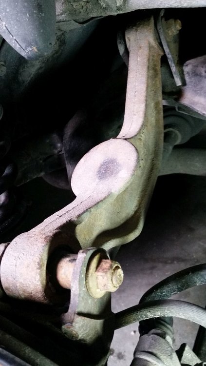

1197sts Posted December 19, 2018 Share Posted December 19, 2018 Correction, I think this is the upper link. This is the right side, the left is worn also but not as bad. Link to comment Share on other sites More sharing options...
heartless Posted December 19, 2018 Share Posted December 19, 2018 whatever it is, it is definitely worn out. hard to say with any certainty what part it is from that picture, however. Link to comment Share on other sites More sharing options...
