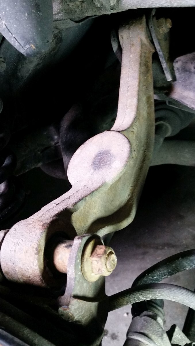

1197sts Posted December 19, 2018 Share Posted December 19, 2018 Sorry for the lack of clarity in this picture, its hard to get a good pic in that area. From what I can tell this is where the upper link attaches to the rear arm. Link to comment Share on other sites More sharing options...
idosubaru Posted December 19, 2018 Share Posted December 19, 2018 5 hours ago, 1197sts said: Sorry for the lack of clarity in this picture, its hard to get a good pic in that area. From what I can tell this is where the upper link attaches to the rear arm. 00-04 outbacks are the same in this regard, here's a diagram which should show the hardware you'll need as well - bolts/washer/nut which often need cut off. https://parts.subaru.com/showAssembly.aspx?makeName=subaru&modelYear=2003&modelName=legacy25l-at-4wdoutback-wagon&ukey_assembly=6029084&ukey_category=54106&assembly=b12-201-02 Link to comment Share on other sites More sharing options...

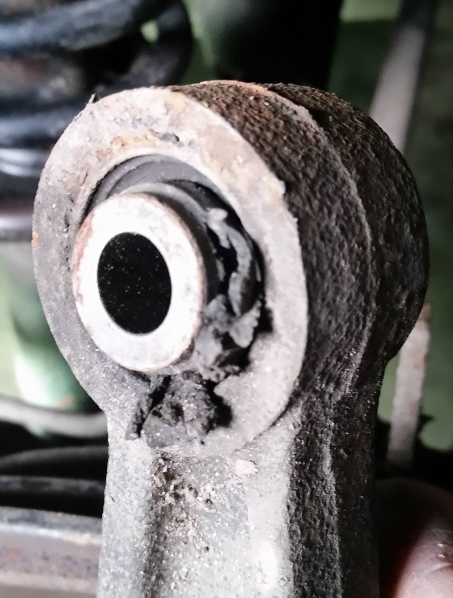

1197sts Posted December 21, 2018 Share Posted December 21, 2018 I replaced the left and right upper links and it improved the ride quite a bit, on the right link the outside mount was quite worn, on the left it was the inside. I am attaching a picture of the left link and a closeup of the worn mount. This job was easier than I anticipated with the wheel removed you don't even have to crawl under the car. Link to comment Share on other sites More sharing options...
