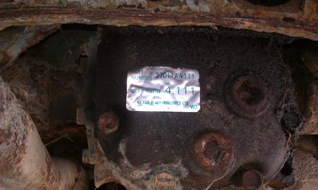

Recian Posted April 28, 2012 Author Share Posted April 28, 2012 (edited) My car is a 95 impreza auto AWD 2.2 Doner was 93 legacy m/t AWD 2.2 Took this off the doner's rear diff. Mine i know is a 4.111 Edited April 28, 2012 by Recian Quote Link to comment Share on other sites More sharing options...
johnceggleston Posted April 28, 2012 Share Posted April 28, 2012 (edited) My car is a 95 impreza auto AWD 2.2Doner was 93 legacy m/t AWD 2.2 yes, both of these are 4.11 ratios. but the other trans from the same years (95 imp 5speed and 93 lego auto) are 3.9 ratio. Edited April 28, 2012 by johnceggleston Quote Link to comment Share on other sites More sharing options...
Recian Posted April 28, 2012 Author Share Posted April 28, 2012 so the legacy auto's were 3.9 and the impreza 5-speeds were 3.9 also even if they were AWD? Im referring to the same era 94-99 impreza and 94-99 legacy. I know pre 94 legacy were different. the square body ones. Quote Link to comment Share on other sites More sharing options...
Recian Posted April 28, 2012 Author Share Posted April 28, 2012 it's good i didnt need the diff. Mine looks brand new now that i've cleaned it and changed it to royal purple oil. My car doesnt have a single spot of rust besides the hood thats wrinkled from a wreck b4 i bought it. You can see from the pic the terrible rust the doner had. The trans surprisingly was just oily. That's probably what saved it lol all the un-maintained engine leaks. Quote Link to comment Share on other sites More sharing options...
johnceggleston Posted April 28, 2012 Share Posted April 28, 2012 (edited) so the legacy auto's were 3.9 and the impreza 5-speeds were 3.9 also even if they were AWD? Im referring to the same era 94-99 impreza and 94-99 legacy. I know pre 94 legacy were different. the square body ones.you need to stop making general statements about FD ratios. they change. rarely are manual and auto the same in the same year. 90 - 91 only i think. turbos not included. FACTS 93 - 99 impreza ej22 & ej18 auto = 4.11 manual = 3.9 93 - 94 legacy ej22 auto = 3.9, manual = 4.11 turbos may be different. 95 - 99 legacy ej22 auto = 4.11, manual = 3.9 96 - 99 ej25 legacy GT, LSi, outback auto = 4.44, manual 4.11 Edited April 28, 2012 by johnceggleston Quote Link to comment Share on other sites More sharing options...
