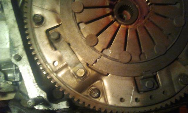

Deener Posted May 2, 2012 Author Share Posted May 2, 2012 Well, I just got it apart and found the pressure plate cracked!!! Ill post a pic tomorrow. Link to comment Share on other sites More sharing options...

GeneralDisorder Posted May 2, 2012 Share Posted May 2, 2012 Well, I just got it apart and found the pressure plate cracked!!! Ill post a pic tomorrow. Very odd indeed. Possibly a warantee issue there. GD Link to comment Share on other sites More sharing options...

Deener Posted May 3, 2012 Author Share Posted May 3, 2012 Heres the crack... Link to comment Share on other sites More sharing options...
GeneralDisorder Posted May 3, 2012 Share Posted May 3, 2012 Looks like a defect to me. See if you can get a warantee replacement. GD Link to comment Share on other sites More sharing options...
