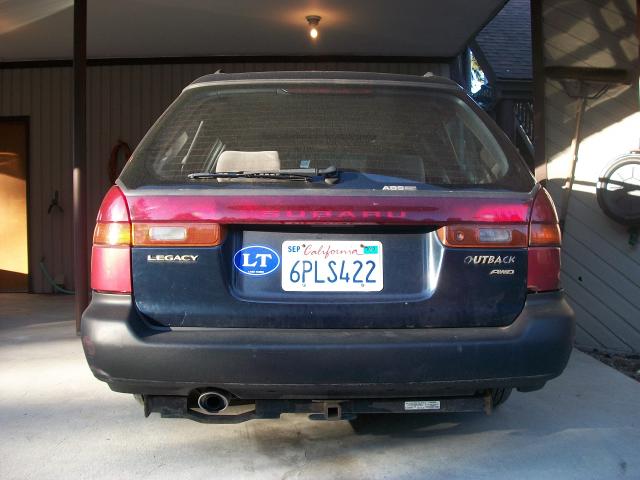

darsdoug Posted May 16, 2012 Author Share Posted May 16, 2012 (edited) The rear hatch is green and say's Outback on it but the rest of the car is red. I'll check the cover's and the casting mark's on the block when I get home from work. And yes, it does have the small foglight's in front. Thank's for your time. Edited November 29, 2013 by darsdoug Quote Link to comment Share on other sites More sharing options...

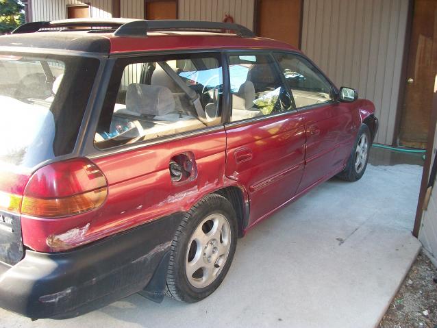

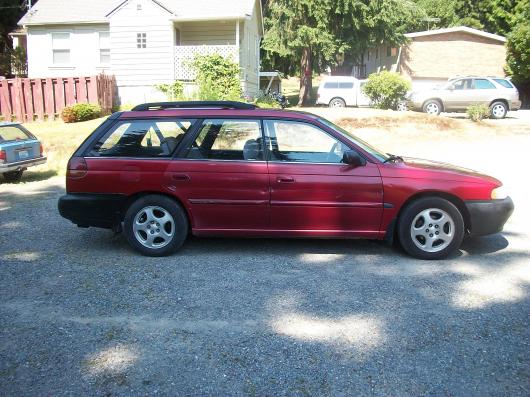

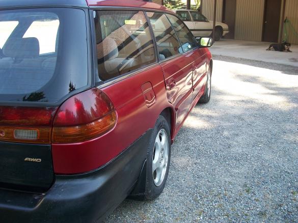

johnceggleston Posted May 16, 2012 Share Posted May 16, 2012 from the pics it looks like it COULD be a GT (ej25), or maybe LSi (ej25), but it is probably an LS (ej22). power antenna, sun roof, roof rack,.... what size tires? do the rocker panels have a plastic, bumper-like, material covering them? any leather in side, steering wheel, shift knob? it is definitely NOT an outback. (paint isn't two tone, roof rack is wrong, no step roof.) they just used outback parts to repair a rear collision. check the engine , if there are 4 cams, 2 round ''lobes'' on each side of the engine in the front is is an ej25. if there are 2 total, one on each side, it is an ej22. Quote Link to comment Share on other sites More sharing options...

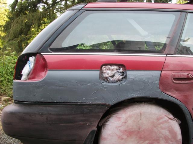

darsdoug Posted October 15, 2012 Author Share Posted October 15, 2012 (edited) from the pics it looks like it COULD be a GT (ej25), or maybe LSi (ej25), but it is probably an LS (ej22). power antenna, sun roof, roof rack,.... what size tires? do the rocker panels have a plastic, bumper-like, material covering them? any leather in side, steering wheel, shift knob? it is definitely NOT an outback. (paint isn't two tone, roof rack is wrong, no step roof.) they just used outback parts to repair a rear collision. check the engine , if there are 4 cams, 2 round ''lobes'' on each side of the engine in the front is is an ej25. if there are 2 total, one on each side, it is an ej22. Yup. Found evidence of a past rear end impact in the basement while roughing out the right rear panel which was messed up. The previous owner said he had bounced off a guard rail during a Montana blizzard. I bought a RF fender and headlamp assembly at the bone yard and got er done. Total out of pocket expense's were less than a hundred bucks. Edited October 27, 2012 by darsdoug Quote Link to comment Share on other sites More sharing options...
