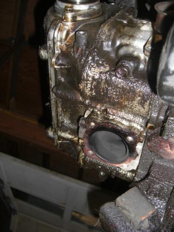

Front main seal looks dry, cam seals look dry..replacing them anyway ( i think)..
Oil is dispersed everywhere making it difficult to pinpoint where it's coming from...I'll do the valve cover gaskets....am I doing the head gaskets?
I can't exactly clean it up and try to recreate a leak with the engine out right?

Trust me, I don't wanna rebuild but reasoned in my brain if I have to take cylinder heads off to install new gaskets in I'm exposing the pistons and dealing with rings...don't wanna do this.

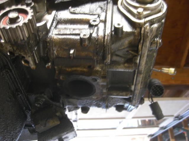

I've just wiped clean the cylinder heads to the block, pretty sure I've got the verbiage right but I could be wrong...

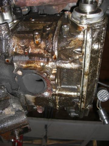

Anyway, the two (four altogether)gaskets closest to the block than the valve covers, (Cylinder head and head gasket??) after having been wiped clean look tighter than a cat's rump roast. There's enough gasket sealer exposed and some head gasket that looks dry, not oozing anything.
The only gasket area that looks oily is the lower valve covers..everything looked oily before wiping but these appear "wet".
Is it possible that all the oil spread on the engine is coming from the lower valve covers??
There's plenty of oil under and around the powers steering unit...everywhere on the front an top front has a nice old thick coating of oil....the oil pan as well, covered kinda thick.
The oil pump itself, looks tight and dry...
I'm thinking of just doing the valve gaskets??, & the cam seals ..Though they look good, & the main front seal??.. though that looks good...
Should I just leave well enough alone at 161,000 miles.
Even my timing belts looked good and am certain they have at least 120,000 miles..

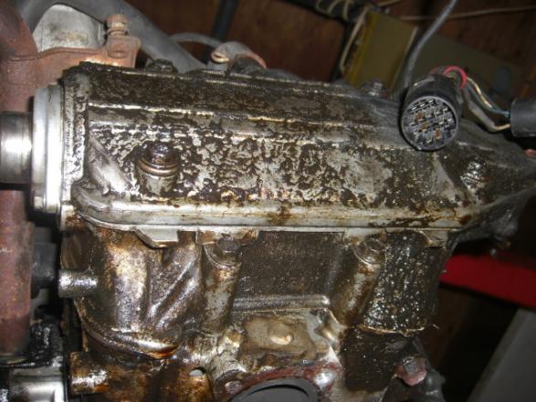

I dunno...a two year old would have had no problem turning the ratchet to get the10mm bolts off which are holding the valve covers on...is this unusual?
As far as the rubber seals of the valve covers?? ..Looks good to me, a little wet, but flexible and no breaks, don't see how theses thing goes bad....but it's the only obvious place where oil might be leaking??
Should the bolts just be cranked tighter??

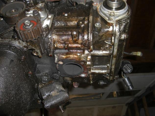

Haven't pulled the trigger on going deeper so am killing time cleaning the engine..
Is there any cleaner I can just spray on and hose off, literally... wire brush and rag and wd40 is getting old.

It may not be a gasket at all, if things are nice and tight and you have good compression. Could be a leaky PCV valve and/or hose. Could be a leaky oil pump, or camshaft seals.
Last but not least, if it's an old motor and never been cleaned...there is a saying (I didn't invent it) that "if it's not leaking, it's probably out".
i vote for the valve covers and the grommets leaking, and the cam tower seam where it meets the head. puling the heads is un-neccessary if there is no HG issues. once you have the cam towers off, you can re-torque the HG.
opening up the bottom end will be a waste of effort as you will see the bottom end will be in good shape.
it is worth pulling the cam towers and re-sealing with permatex ultra grey or better yet, an anaerobic sealer, and replace the o-ring that is in there.

cam seals and oil pump look good.
Do the cam seal have a designated life span? I'll prob change them..
Re: oil pump, the engine was doing intermittent ticking, usually upon starting but would disappear somewhere down the road...hoping that changing the seals, filter and new oil will correct this....I read the pumps themselves rarely go bad??
Side note: It seems every two weeks I was putting in nearly a quart of oil ...because of this I slacked on doing a real oil change...prob not smart.. still strong engine finally getting attention.

When I mentioned lower valve covers, I meant the seams at bottom of the valve cover itself...the cam towers which after wiping look as dry as the head at the block....maybe it's just cause I wiped em dry..heh.
I'm glad you vote the grommets and the valve covers...the grommet and seals with the grommets do look like a replacement is needed.
That said maybe I'll do the cam towers ..

I don't know of any particular life span on the various engine seals, but the rubber ones do get old, worn, or dry out with time. It doesn't hurt to replace them if you already have things apart. They aren't a big job like the headgasket, just a few minutes with a wrench. The are no different from hoses and belts in terms of being prone to age induced damage. If you're putting in a quart a week, it's coming out somewhere! I vote for cam seals, the cam seam, and valve covers and grommets as well. Wouldn't hurt to do the oil pump seals too, as long as you have the timing belts off.
Parts stores have degreasers you can spray on and hose off, no scrubbing necessary. Some hose based carwashes may also have a "tires and engines" wash option, I've used the local one here quite a bit and it seems to do well.
