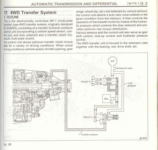

You probably have a bad duty-c solenoid. Check the TCU codes - if the AT Temp light flashes 16 times on startup then you have stored TCU codes. There is a 6 pin black connector above the gas pedal and two grounding wires wrapped into the harness directly above that. Insert one grounding pin into the center pin on the black connector (blue with yellow trace typically), then follow this process:
