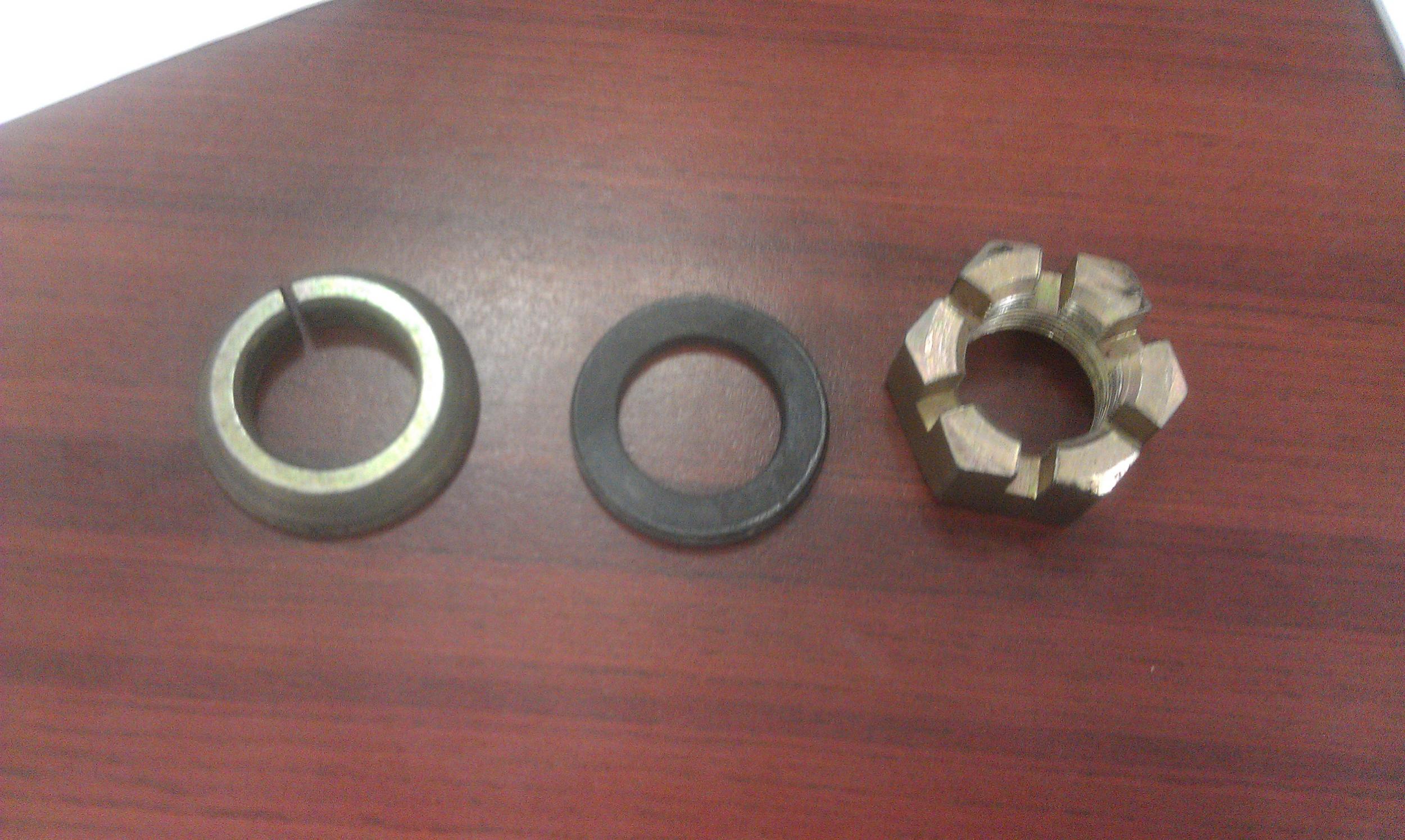

simplebliss Posted June 1, 2012 Share Posted June 1, 2012 So for a couple days now ive been trying to find this part for my subaru... nobody has it listed... recently replaced the front passenger cv axle... i noticed that unline the drivers side the washer behind the castle nut is gone... an the part that goes behind that is just about toast... local part stores look at me funny.. according to there books it's just castle nut an washer... but on the drivers side of my car there is castle nut washer then... not sure what to call it... looks like a washer but has a kinda shoulder part then a dome... any idea as to what this is?? id take pics.. but no camera the chiltons manual dont even show it as being there... so cunfused... thank you for your time Quote Link to comment Share on other sites More sharing options...

simplebliss Posted June 1, 2012 Author Share Posted June 1, 2012 think i figured it out.. google google google an more google led me pack to a post on this board talking about a cone washer... found a pic... an mine is WAY past due to be replaced.. i think... im gonna pulled the one off the other side to make sure... still... local part stores dont have them listed.. Quote Link to comment Share on other sites More sharing options...

GeneralDisorder Posted June 2, 2012 Share Posted June 2, 2012 Cone washer is a dealer only part. It's actually a mechanical shaft locking ring. Such things are common in machinery but not in automotive. GD Quote Link to comment Share on other sites More sharing options...

simplebliss Posted June 7, 2012 Author Share Posted June 7, 2012 (edited) first... shawn w.. thank you very much for the offer.. i picked up the cone washer an the other washer at the arlington pick an pull for .57 cents today... i figured i would post a pic just to show how bad it was.... hopefully that worked buddy of mine was nice enuff to swing by with his webcam on his way home from work Edited June 7, 2012 by simplebliss forgot something Quote Link to comment Share on other sites More sharing options...
ShawnW Posted June 8, 2012 Share Posted June 8, 2012 Sweet, that one looked BAD but not the worst I have seen. That would be the one where that part was gone from a brake shop losing it and not informing the customer. Quote Link to comment Share on other sites More sharing options...
