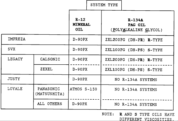

porcupine73 Posted June 14, 2012 Share Posted June 14, 2012 There used to be an Endwrench article about how to figure the oil. I forget exactly what it said, but I think the 8.x fl. oz. was the total amount of oil in the system. Then it had some estimations you could make, since it is not really practicable to measure the amount of oil in the system. Such as so much for a compressor replacement, so much for the receiver/drier, stuff like that. I don't think you're supposed to mix the PAG and ester oils. Subaru had a 12 to 134A conversion kit available for certain years/models. Because I think the expansion valve is different too between the refrigerants. Quote Link to comment Share on other sites More sharing options...

porcupine73 Posted June 19, 2012 Share Posted June 19, 2012 I just happened to find this while looking for something else so I thought I'd add it to the thread: I found some of the endwrench articles for the retrofit but it wouldn't let me attach them. Quote Link to comment Share on other sites More sharing options...
