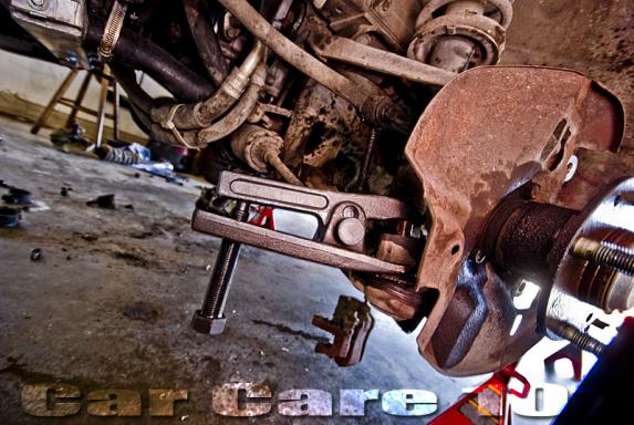

l75eya Posted June 14, 2012 Share Posted June 14, 2012 Can't seem to get that sucker out. Does I really have to remove the control arm and bring it to a shop to get the balljoint out of it, or does somebody know a trick? Gonna look through the FSM and my Haynes, I would have done that first before asking, but the car is all torn apart now and so..i'm looking for a (hoping for a) SWIFT solution. Woosh! haha thanks ahead of time Car is a FWD Loyale btw. Link to comment Share on other sites More sharing options...

AKghandi Posted June 14, 2012 Share Posted June 14, 2012 i went to the local parts store and rented a balljoint puller... before i did that i spent 5 long angry hours trying to get it out. torches, hammers, logs, sacrificing chickens, and alot of pb blaster mine wasnt even rusted, after i got the tool it still took alot of effort and 3 guys to get that magical "pop!" have fun! if you have the income to take it to a shop....DO IT!! Link to comment Share on other sites More sharing options...
l75eya Posted June 14, 2012 Author Share Posted June 14, 2012 Okay so there's nothing I'm missing though, right? It's just stuck more than a ...well....it's stuck? Like I said, it's already out of the steering knuckle, the stud is still going thru the control arm and through everything I've done so far (Pickle fork, torches, hammer, and chickens) judging by the hole for the castellated nut...it doesn't look like I've gotten it to move up through the control arm at *all*. Tie rods are done. Those were easy. Ball joint is PISSING ME OFF lol Link to comment Share on other sites More sharing options...

tractor pole Posted June 14, 2012 Share Posted June 14, 2012 I used a tie rod end puller, it was small enough to fit around the control arm and a couple good turns later it was out! good luck Ben Link to comment Share on other sites More sharing options...

l75eya Posted June 14, 2012 Author Share Posted June 14, 2012 tractor pole said: I used a tie rod end puller, it was small enough to fit around the control arm and a couple good turns later it was out! good luck Ben See that's the issue I'm having with the ball joint press tool I borrowed from a buddy (The big rump roast clamp style) All of the spacers don't sit flush on the control arm, and only one of them (the largest) rises up high enough to give the ball joint some clearance to move upward. The issue is that the stud (and the joint itself in that respect) is at a slight angle and it's causing me a ton of issues. Maybe I'll take a look at a tie rod end puller and RV; I was putting everything I had into hammering the pickle fork in there, and it didn't do a damn thing the rubber boot is ...gone. That's all I accomplished. Link to comment Share on other sites More sharing options...
Stubies Subie Posted June 14, 2012 Share Posted June 14, 2012 I went to harbor freight and bought one of these for about $8.00, I tightened it down, gave it a good smack with a 3 lb hammer, and it popped right out Link to comment Share on other sites More sharing options...
Scott in Bellingham Posted June 15, 2012 Share Posted June 15, 2012 give the cast arm a good smack with a hammer on the side it will shock the hole and deform it for a moment and the tapered shaft will fall out, works sometimes Link to comment Share on other sites More sharing options...
l75eya Posted June 15, 2012 Author Share Posted June 15, 2012 Got it out! I let my anger get the best of the hammer and the pickle fork and after some very agressive swinging, it finally popped out. So today I got the tie rod and tie rod end installed on the passanger side, and the ball joint. I was having trouble with the strut, probably because I have some crappy cheap spring compressor, and I don't have a vice, so it was very difficult to get good leverage on the whole thing. Because it's already removed from the car, I think I'm just going to take the strut assembly to a garage tomorrow and see if they'll remove the spring for me and switch it over to the new shock, and then i'll do the same for the driver's side when I'm at that point. Was hoping to not have to go to a shop for any part of the job, but having the right tool is what it's all about, and I just don't. =\ Oh well. More fun tomorrow! Thanks for the tips/ideas/links Any future search references, pickle fork seems to be the best way to get the ball joint out. It may seem like it's not working but you gotta make sure you wedge it from various angles. Hammer the pickle fork on one side, wrangle it around a bit, then remove it and hammer it back in on the opposite side, then from the front. Gotta work that fork, yo. Link to comment Share on other sites More sharing options...

Gloyale Posted June 15, 2012 Share Posted June 15, 2012 l75eya said: Any future search references, pickle fork seems to be the best way to get the ball joint out. It may seem like it's not working but you gotta make sure you wedge it from various angles. : Glad you got it. Pickle fork is the tool for the job. I only use the puller if I'm trying to save the balljoint. If it's done, hammer away. Link to comment Share on other sites More sharing options...

l75eya Posted June 17, 2012 Author Share Posted June 17, 2012 Moosen said: is it possible to remove the ball joint fromt he control arm without a pickle fork. I removed it fromt he knuckle already easily, but i have just been banging up on the castle nut to try and get it to pop out of the control arm? is that possible? Not likely...especially if it's as stuck as the one was on my passanger side. The only way I can think of that working is if you prop something very solid underneath the ballstud and then hammer the control arm downward. If you bang on the castle nut, it's just going to strip out. If you need pickle forks, I recommend http://www.ebay.com/itm/Grip-On-Tools-5-pc-Pickle-Fork-Kit-21318-/330744485186?hash=item4d01e85542&item=330744485186&pt=Motors_Automotive_Tools&vxp=mtr They are cheaply priced, but they're above quality for the price. I had no complaints while using them. Link to comment Share on other sites More sharing options...
