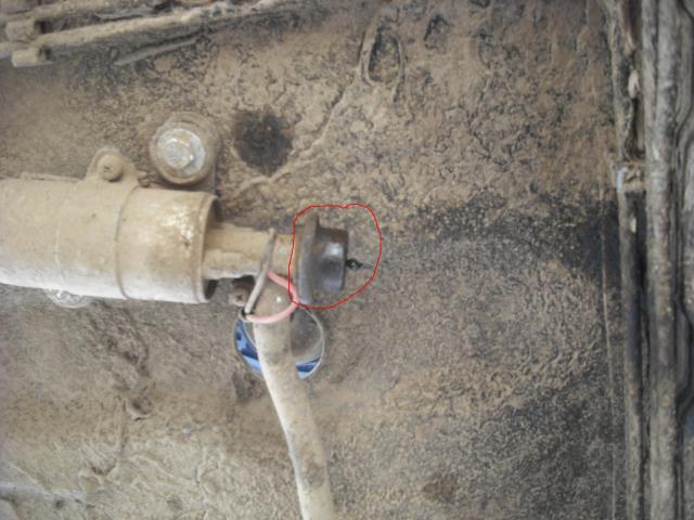

Uberoo Posted June 23, 2012 Share Posted June 23, 2012 I have an SPFI fuel pump from an EA subaru powered my ej22 powered offroader.I just found out that the little damper or regulator that is attached to the unit is leaking fuel.Is there anyway to just replace that with a 90* fitting and have no ill affects? Link to comment Share on other sites More sharing options...

Uberoo Posted July 1, 2012 Author Share Posted July 1, 2012 does this part come off? Link to comment Share on other sites More sharing options...
Quidam Posted July 1, 2012 Share Posted July 1, 2012 That part around here rusts out and leaks. Removed one from a Loyale not long ago and put on a different pump. You might be able to just cut it off after the fuel line and cap the end some how. That part is crimped together. There is a fuel damper on SPFI cars "after" that fuel line connection. Between the fuel pump and fuel filter. Doug Link to comment Share on other sites More sharing options...
