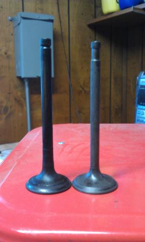

soobiefreak85 Posted June 23, 2012 Share Posted June 23, 2012 I just bought these on Ebay...do I need to return them? They are new and said they would fit EA81, EA82, and EA82T...1980-1989. I have a EA81 1987 Standard. It is a little shorter and the notch is wider? Should I return it, or will it work just fine? Thoughts? Link to comment Share on other sites More sharing options...
Quidam Posted June 23, 2012 Share Posted June 23, 2012 (edited) I just bought these on Ebay...do I need to return them? They are new and said they would fit EA81, EA82, and EA82T...1980-1989. I have a EA81 1987 Standard. It is a little shorter and the notch is wider? Should I return it, or will it work just fine? Thoughts? Yea, long day but here's mine. The left one may be EA 81 exhaust, they have a thicker stem than the EA 82 valve. Doug Edited June 24, 2012 by Quidam Link to comment Share on other sites More sharing options...
soobiefreak85 Posted June 24, 2012 Author Share Posted June 24, 2012 The one on the left is original exhaust. The one on the right is the one ordered, it is an exhaust as well. Just concerned about the slight height difference and notch difference. Link to comment Share on other sites More sharing options...
Quidam Posted June 24, 2012 Share Posted June 24, 2012 Yea, those are the wrong valves for your motor and won't fit. Link to comment Share on other sites More sharing options...

Crazyeights Posted June 28, 2012 Share Posted June 28, 2012 There are at least (2) types of EA81 valves I am aware of. I just went through this with the EA81's I recently rebuild. I don't remember the specifics but EA81 Hydro, Solid, and EA81T may all have different lengths and or clip locations. Link to comment Share on other sites More sharing options...

ivans imports Posted June 28, 2012 Share Posted June 28, 2012 valves change in 83 the differance is whether has extra two bolts on lower part of head 10 mm s if has bolts ealy if no bolts late the late one has bigger valves posibly longer to Link to comment Share on other sites More sharing options...
