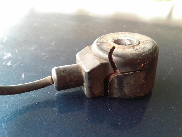

cohophysh Posted June 30, 2012 Share Posted June 30, 2012 90 leg 2.2, I just replaced the knock sensor, however, I did not put it back where it came. I found a bolt hole up and just towards the firewall that was easy access. So I mounted it there. Seems to me all the knock sensor needed was good contact to the block, so basically it could go anywhere the wire would reach. Is this right? B btw...knock sensor was in bad shape. split housing rusty...yuk Link to comment Share on other sites More sharing options...

cohophysh Posted July 2, 2012 Author Share Posted July 2, 2012 here it is Link to comment Share on other sites More sharing options...
