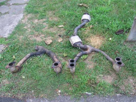

schekan Posted July 25, 2012 Author Share Posted July 25, 2012 Yep I went to a local u pullit junk yard today and hit pay dirt. first isle second car was a 2.2 not sure of the year but it was a single port exhaust. They already had the cat cut off so less work for me. $12.50 and 15 minutes later i had my exhaust. I am taking photos step by step and am going to post them. So far so good. I was just wondering about the intake, I will try it. If it starts throwing the check engine light with codes I will just put my intake that came with it on. I wanted to try because it is already attached to the motor, i figured why not. Link to comment Share on other sites More sharing options...

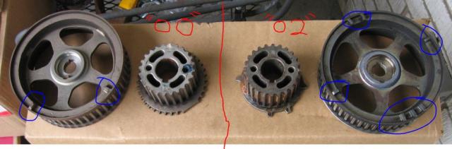

schekan Posted July 28, 2012 Author Share Posted July 28, 2012 (edited) sprockets are definitely different , tomorrow timing belt and oil seal. and my original sprockets and I think that should do it.. Edited July 28, 2012 by schekan Link to comment Share on other sites More sharing options...
themoneypit Posted July 29, 2012 Share Posted July 29, 2012 (edited) cant wait to see how this works out. not bad if all you have to do is swap intake, and couple sprockets. def worth the better 2.2 in the long run. wonder why you only have to swap the left cam sprocket, and not both?? just wondering. keep us posted on how this goes. thx Edited July 29, 2012 by themoneypit Link to comment Share on other sites More sharing options...
schekan Posted July 29, 2012 Author Share Posted July 29, 2012 (edited) OK, 2.2L from "00" impreza Y-pipe from an imprezza of unknown year, but it was a phase 1 2.2L My original intake from my 02 outback My crank and drivers side cam sprockets (new timing belt while i am there) Got it all together today and it purrs like a kitten. I am impressed... I only took it for a quick test drive but it runs so smooth. Much better engine. Attached pic is of the exhaust.. Edited July 29, 2012 by schekan adding more text Link to comment Share on other sites More sharing options...

Fairtax4me Posted July 29, 2012 Share Posted July 29, 2012 cant wait to see how this works out. not bad if all you have to do is swap intake, and couple sprockets. def worth the better 2.2 in the long run. wonder why you only have to swap the left cam sprocket, and not both?? just wondering. keep us posted on how this goes. thx Left sprocket has teeth for the cam position sensor to read. Right sprocket does not. No point in changing it if it's no different than the one you take off. It is a good idea to remove it and replace the cam seal while you have the timing components out of the way. Link to comment Share on other sites More sharing options...
