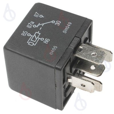

crazyman03 Posted August 18, 2012 Share Posted August 18, 2012 i can't remember what type of relay they have in there but you can test it to be sure with just some wire (speaker wire works) and your battery. usually, the numbers match up and a lot of the time there are diagrams on the relay itself before you do anything, If you have a DMM, probe for connectivity between "30" and "87a" it should be good. apply +12 power to "85" and "86" (doesnt matter which polarity), and it should click. with power applied, now probe between "30" and "87a" again-there shouldn't be any connectivity. probe "30" and "87" - you should have connectivity. If all that works, then the relay is fine. this is for a standard "accessory" relay so double check what yours is before probing. This should give you an idea if there is a diagram on the relay you have, you can see how it works in order to test it. -Justin Link to comment Share on other sites More sharing options...
