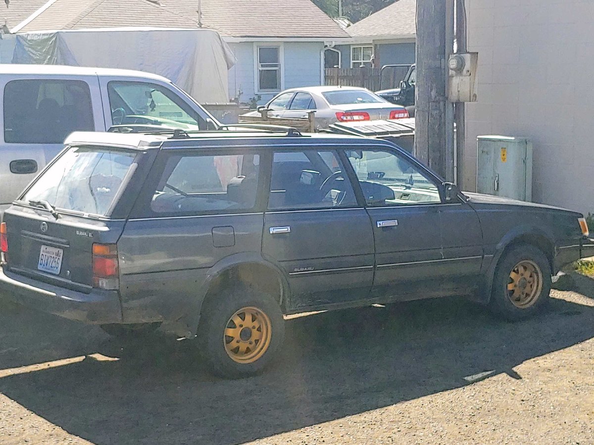

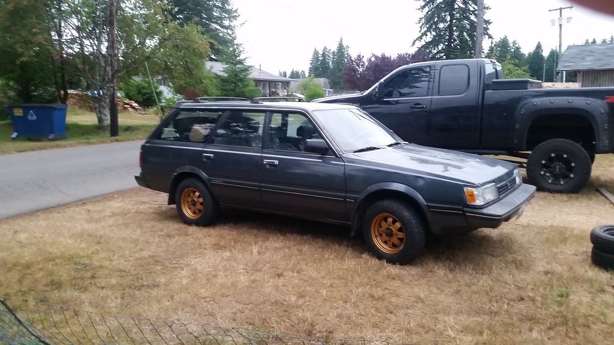

Logan K Posted March 9, 2017 Share Posted March 9, 2017 In that case I'm going with the Bilstein 24-187244. Yellow shocks for my yellow springs Link to comment Share on other sites More sharing options...
Naked Buell Posted March 10, 2017 Share Posted March 10, 2017 Pics would be cool. Link to comment Share on other sites More sharing options...
