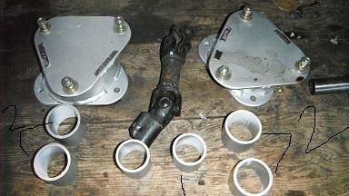

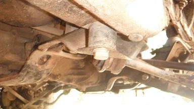

92loyale59 Posted July 31, 2013 Share Posted July 31, 2013 (edited) i would say its more than nessasarry to have the x member spacer. without it your axles WILL hit you xmember right above the inner control arm mounts. i had the same lift. also with out x member spacer your car will lift up when driving and your tires and handling will be garbage . . . just my opinion but i would do what i did. make 1.5 inch spacers for the engine x member and extend steering shft 1 inch and make 6 total round spacers for radious rod mounting bracket and the tranny x member. you will need all longer bolts also. also when installing rear lift make sure to turn strut and spring assembly around 180 degrees and mount it up like that. i wouldnt even put the lift on and drive on it till engine and tranny and radius rods are dropped. i went through about 10 axles total within like 2 months befor i made the rest of the lift and now i haven't broken a single one and i have put over 10000 miles on it. also lifted another loyale and sold it with same lift and the buyer has yet to have any problems with it. i can post pictures and dimensions of lift spacers if you need them Edited July 31, 2013 by 92loyale59 1 Link to comment Share on other sites More sharing options...
ystrdyisgone Posted August 4, 2013 Author Share Posted August 4, 2013 On 7/31/2013 at 6:59 PM, 92loyale59 said: i would say its more than nessasarry to have the x member spacer. without it your axles WILL hit you xmember right above the inner control arm mounts. i had the same lift. also with out x member spacer your car will lift up when driving and your tires and handling will be garbage . . . just my opinion but i would do what i did. make 1.5 inch spacers for the engine x member and extend steering shft 1 inch and make 6 total round spacers for radious rod mounting bracket and the tranny x member. you will need all longer bolts also. also when installing rear lift make sure to turn strut and spring assembly around 180 degrees and mount it up like that. i wouldnt even put the lift on and drive on it till engine and tranny and radius rods are dropped. i went through about 10 axles total within like 2 months befor i made the rest of the lift and now i haven't broken a single one and i have put over 10000 miles on it. also lifted another loyale and sold it with same lift and the buyer has yet to have any problems with it. i can post pictures and dimensions of lift spacers if you need them Thanks for the heads up. This is what I was wondering about. Was about to cross my fingers and hope the lift had no ill effects on the car. Sounds like I will regret that though. If you could post pics or dimensions that would be great. I'm having trouble picturing the radius rod spacers. Link to comment Share on other sites More sharing options...
bratman18 Posted August 4, 2013 Share Posted August 4, 2013 I have had many 2" lifts on EA82 cars with no crossmember spacers. I never broke an axle on one and I abused them. The lifting of the front end on acceleration is caused by bad alignment after the lift. If you toe your tires out a little on each side, it will get rid of a lot of that problem and help with tire wear as well. Link to comment Share on other sites More sharing options...
AKghandi Posted August 4, 2013 Share Posted August 4, 2013 On 8/4/2013 at 11:47 AM, bratman18 said: I have had many 2" lifts on EA82 cars with no crossmember spacers. I never broke an axle on one and I abused them. The lifting of the front end on acceleration is caused by bad alignment after the lift. If you toe your tires out a little on each side, it will get rid of a lot of that problem and help with tire wear as well. yeah on both my wagos the worst that has happens is the boots split, after i replaced them with good quality new ones i havent had an issue. i have noticed the tire wear on my mud tires but on the street tires i havent noticed any wear in the 4000 or so miles its had the lift. Link to comment Share on other sites More sharing options...
92loyale59 Posted August 8, 2013 Share Posted August 8, 2013 well it is just my opinion but yeah it ruined my general grabers veryvery quickly just on the front two. i just know that when my car wasflexing the axles would touch the engine cross member also when i wouldgo through huge mud pits or anything to quickly i would tear the boots. ijust found this to be way more effective and very simple way to fix it.i could be wrong though. any ways here is the picture i have of theradius rod spacers. 1.5 inchs tall by 1.75 inches O.D and 1/8 inch wallthickness. The pieces marked 1 are for the furthest back on the radius rod brackets. so not the bolt that holds the tranny x member up and not the closest to the front of the car. hope that makes sense. those spacers are a tiny bit smaller in th O.D like by a 1/8 of a inch at most i just dont have those measurments. the ones marked 2 are for the rest of the tranny x member and Radius rod. the rest of photos are it installed if i were to do it again though i would make only two of them (the ones for the tranny x member ) the dimensions i gave you and make the othe four the size that is just a bit smaller around. Link to comment Share on other sites More sharing options...
92loyale59 Posted August 8, 2013 Share Posted August 8, 2013 sorry those markings arent as clear as i thought haha . the smaller ones are in the center (on the first picture) Link to comment Share on other sites More sharing options...
92loyale59 Posted August 8, 2013 Share Posted August 8, 2013 also the cross member blocks are not in that picture Link to comment Share on other sites More sharing options...
ystrdyisgone Posted August 9, 2013 Author Share Posted August 9, 2013 Thanks for the pics and details. I'm still on the fence about spacers, but if I do decide to do them, I may go this route. Nice and simple looking! Link to comment Share on other sites More sharing options...

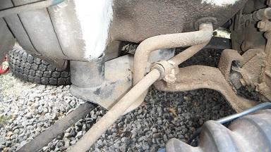

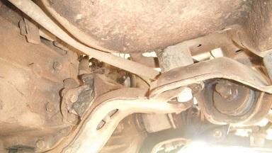

ystrdyisgone Posted September 6, 2013 Author Share Posted September 6, 2013 So this happened today.. Got the rears on with no issues whatsoever. But then I got to the front, and now I'm stuck with this: Sway bar linkage is off, disconnected the control arm bolt(though that probably didn't do much) I don't really know what to try from here. Turns out I don't have a 17mm wrench to remove the radius rod, nor do I have a breaker bar long enough to loosen the two bolts at the other end of the radius rod. I'm wary about popping the knuckle off the ball joint because the only way i've seen to get them back on is a 4 foot breaker bar to wedge the control arm back into place. Any suggestions? Please? Link to comment Share on other sites More sharing options...
bratman18 Posted September 6, 2013 Share Posted September 6, 2013 Attach the lift block to the strut, then bolt the top in, then work the bottom of the strut into the knuckle. Might need a hand to work it in, but it'll go. Link to comment Share on other sites More sharing options...
ystrdyisgone Posted September 7, 2013 Author Share Posted September 7, 2013 I did that, for a little bit anyway, then gave up. I shall try again! Link to comment Share on other sites More sharing options...
ystrdyisgone Posted September 7, 2013 Author Share Posted September 7, 2013 (edited) Whew.. well I finally got that all finished up. I ended up taking off the tie rod as well, that gave me a bit more wiggle room. I couldn't get the knuckle to sit still while I was trying to get the strut in so I had to do this: But it still wasn't enough, so it turned into this: And the other side was as smooth as butter, so that was nice. Here she is! A little dark, but oh well. P.s. Thanks bratman18 for the advice on the fronts Edited September 7, 2013 by ystrdyisgone 1 Link to comment Share on other sites More sharing options...
